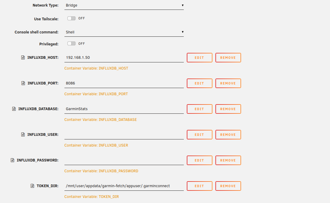

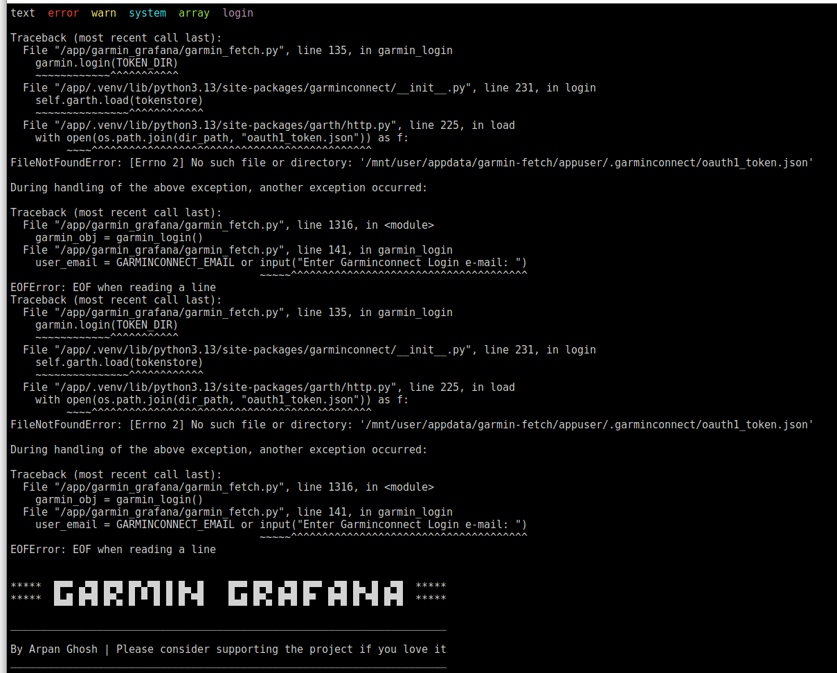

  1. I got this to work - added a path for the drive modified the TOKEN_DIR to start at the path Manually copied the oath json files that were created during the easy-setup script. (not sure this was necessary) - ran the container in Privileged mode and interactively. Turned off and restarted, its now running fine.

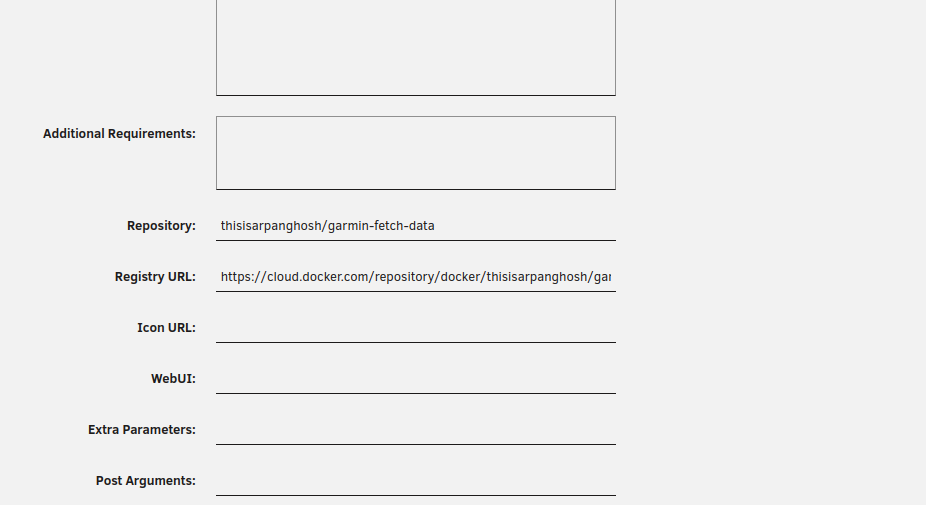

  2. Hello, I'm trying to set up a single container from this project https://github.com/arpanghosh8453/garmin-grafana and running in to an error I can't figure out. (I'm a new to linux and containers). The automated 'easy_setup' script does work, but I already have instances of Grafana and InfluxDB running and the script sets up new separate instances. I manually created the GarminStats database in Influx I imported the Grafana dashboard and even connected it to my (now empty) database The issue is the Garmin Fetch container ... The issue feels like an unraid docker engine issue, so starting here. Thanks! Attached are some screenshots of my setup and the error
