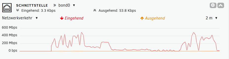

  4. yes, i tried that with the same problem. with 5-13ms ping i would not speak of high latency my w-lan devices usually have a higher latency. What surprises me is that when i use an ubuntu server or arch at home i have none of these problems with nfs . i can transfer 3 tb without any problems at maximum speed. Just like Rclone does from dropbox to unraid. This is how it looks when i transfer a single 10GB testfile to my unraid server ,it doesent matter if i use my remote server or laptop in the same network @ home.
  5. Hello, I have a big problem with UNRaid. I want to use Unraid as data storage for my remote server. I have 1GBit in both directions at home and in the data centre. When I send data from my remote server to Unraid, the transfer drops from an initial 900mbit to a few kbit and then increases again, at the end only about 100gb per day is transferred. When I download the same files from my cloud with Rclone, 6-7 TB are transferred in the same time. I have tried: NFS3/4= data throughput collapses. SSHFS = same result. SMB = same result. 100 of possible mount and export options were tried. Tested everything with Tailscale and Wireguard, even without tunnelling. Client is an i5-13500 with 128GB RAM Ubutu 24.04 the funny thing is when i start another ubuntu server at home it works without problems, and my friend has the same setup with same issue. I just don't know what to do. tower-diagnostics-20250316-0856.zip
