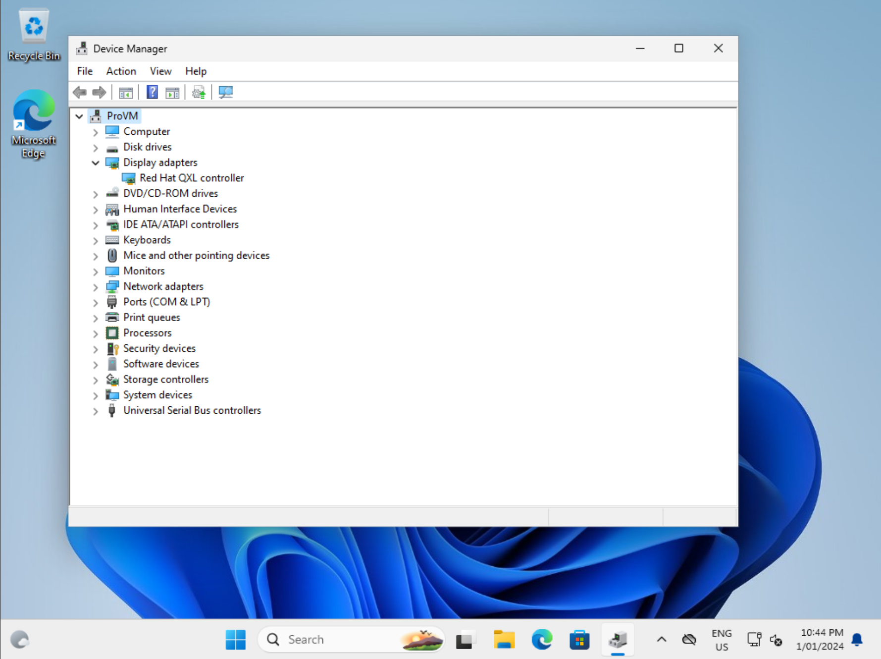

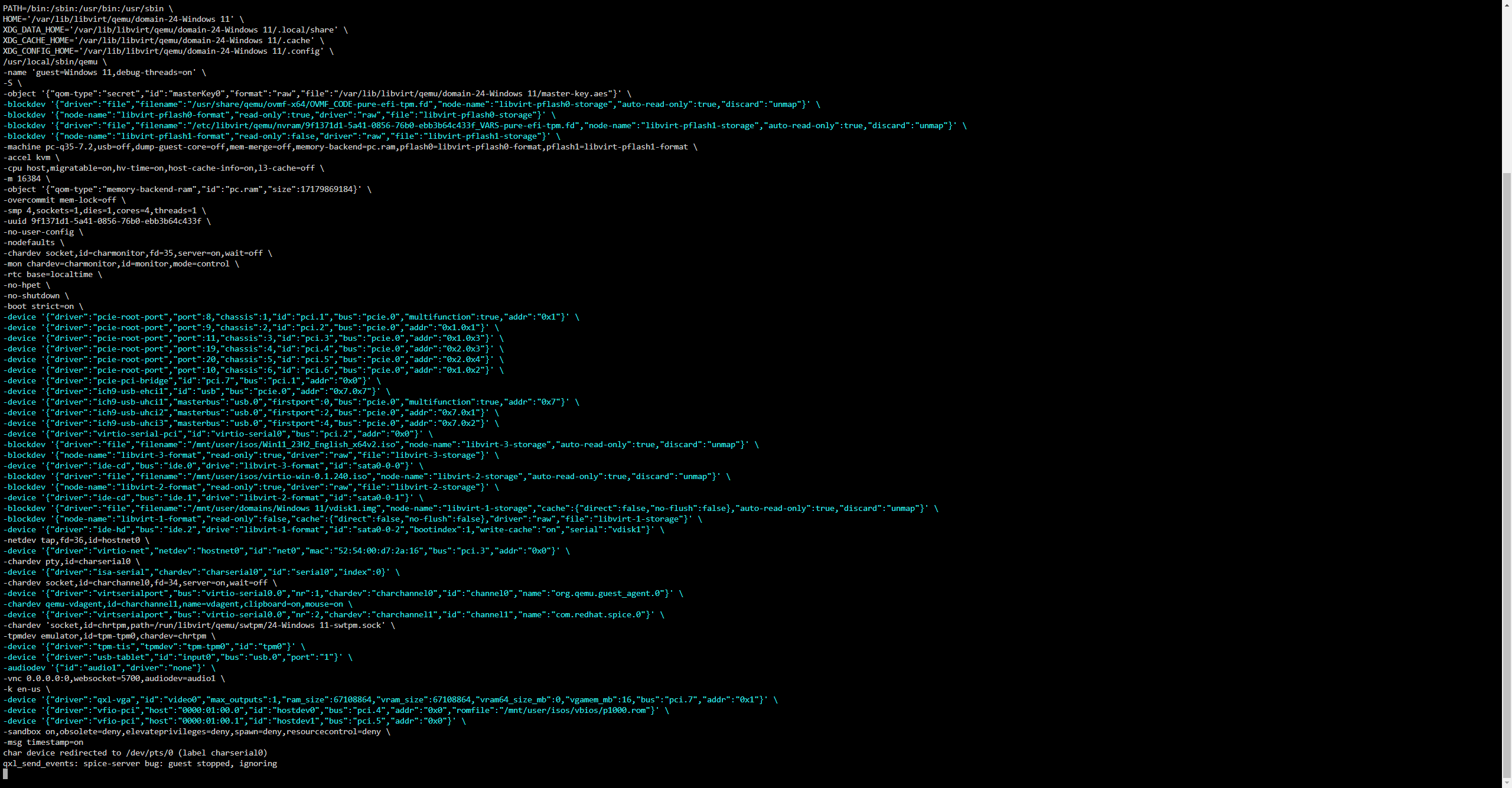

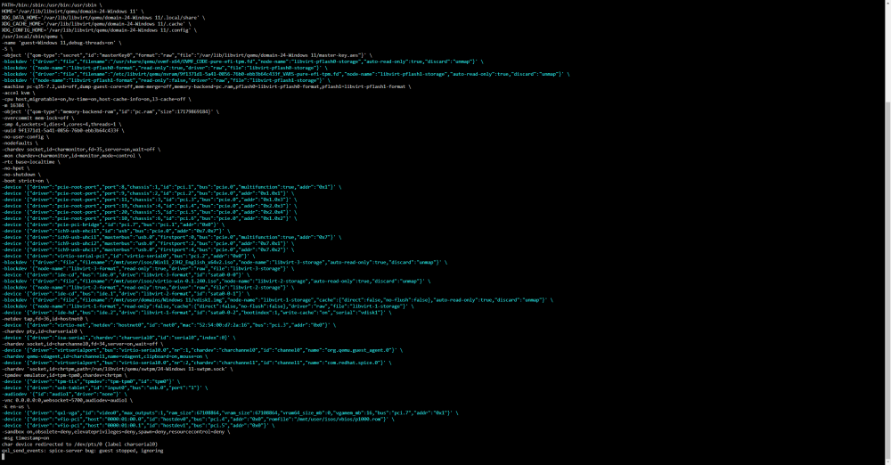

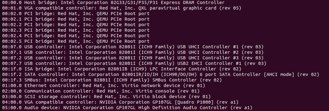

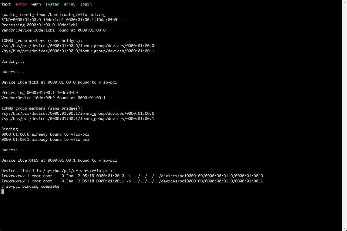

  1. GPU passthrough does not seem to work with windows in unraid. This server was running proxmox yesterday Here is a list of things that do work: - [x] GPU passthrough for linux/ubuntu (both unraid and proxmox) - [x] GPU passthrough for windows within proxmox (same hardware) - [x] VirtIO device passthrough (so non-direct hardware) - [ ] GPU passthrough for windows in unraid Here are the things I have tried: - [x] Binding VFIO at boot - [x] Enabling PCIe ACS override - [x] Disabling/reenabling hyperV - [x] Disabling/Enabling SPICE (as the primary GPU) - [x] Disabling/Enabling VNC (as the primary GPU) - [x] Disabling/Enabling the sound card of the GPU - [x] Including and excluding a GPU vBios - [x] Connecting a monitor to the output of the GPU (monitor turns on with linux install, not with the windows install) - [x] Moving CPU cores - [x] Moving the GPU to a different PCI-e slot - [x] Recreating the VM - [x] Passing the GPU as a device outside of the graphics passthrough **Sometimes** I get this error (after running the windows VM after changing a setting): ``` internal error: qemu unexpectedly closed the monitor: 2024-01-02T06:41:37.639667Z qemu-system-x86_64: -device {"driver":"pcie-pci-bridge","id":"pci.7","bus":"pci.1","addr":"0x0"}: Bus 'pci.1' not found ``` Otherwises I get no errors in the logs I am really stumped on why windows isn't working ``` PATH=/bin:/sbin:/usr/bin:/usr/sbin \ HOME='/var/lib/libvirt/qemu/domain-24-Windows 11' \ XDG_DATA_HOME='/var/lib/libvirt/qemu/domain-24-Windows 11/.local/share' \ XDG_CACHE_HOME='/var/lib/libvirt/qemu/domain-24-Windows 11/.cache' \ XDG_CONFIG_HOME='/var/lib/libvirt/qemu/domain-24-Windows 11/.config' \ /usr/local/sbin/qemu \ -name 'guest=Windows 11,debug-threads=on' \ -S \ -object '{"qom-type":"secret","id":"masterKey0","format":"raw","file":"/var/lib/libvirt/qemu/domain-24-Windows 11/master-key.aes"}' \ -blockdev '{"driver":"file","filename":"/usr/share/qemu/ovmf-x64/OVMF_CODE-pure-efi-tpm.fd","node-name":"libvirt-pflash0-storage","auto-read-only":true,"discard":"unmap"}' \ -blockdev '{"node-name":"libvirt-pflash0-format","read-only":true,"driver":"raw","file":"libvirt-pflash0-storage"}' \ -blockdev '{"driver":"file","filename":"/etc/libvirt/qemu/nvram/9f1371d1-5a41-0856-76b0-ebb3b64c433f_VARS-pure-efi-tpm.fd","node-name":"libvirt-pflash1-storage","auto-read-only":true,"discard":"unmap"}' \ -blockdev '{"node-name":"libvirt-pflash1-format","read-only":false,"driver":"raw","file":"libvirt-pflash1-storage"}' \ -machine pc-q35-7.2,usb=off,dump-guest-core=off,mem-merge=off,memory-backend=pc.ram,pflash0=libvirt-pflash0-format,pflash1=libvirt-pflash1-format \ -accel kvm \ -cpu host,migratable=on,hv-time=on,host-cache-info=on,l3-cache=off \ -m 16384 \ -object '{"qom-type":"memory-backend-ram","id":"pc.ram","size":17179869184}' \ -overcommit mem-lock=off \ -smp 4,sockets=1,dies=1,cores=4,threads=1 \ -uuid 9f1371d1-5a41-0856-76b0-ebb3b64c433f \ -no-user-config \ -nodefaults \ -chardev socket,id=charmonitor,fd=35,server=on,wait=off \ -mon chardev=charmonitor,id=monitor,mode=control \ -rtc base=localtime \ -no-hpet \ -no-shutdown \ -boot strict=on \ -device '{"driver":"pcie-root-port","port":8,"chassis":1,"id":"pci.1","bus":"pcie.0","multifunction":true,"addr":"0x1"}' \ -device '{"driver":"pcie-root-port","port":9,"chassis":2,"id":"pci.2","bus":"pcie.0","addr":"0x1.0x1"}' \ -device '{"driver":"pcie-root-port","port":11,"chassis":3,"id":"pci.3","bus":"pcie.0","addr":"0x1.0x3"}' \ -device '{"driver":"pcie-root-port","port":19,"chassis":4,"id":"pci.4","bus":"pcie.0","addr":"0x2.0x3"}' \ -device '{"driver":"pcie-root-port","port":20,"chassis":5,"id":"pci.5","bus":"pcie.0","addr":"0x2.0x4"}' \ -device '{"driver":"pcie-root-port","port":10,"chassis":6,"id":"pci.6","bus":"pcie.0","addr":"0x1.0x2"}' \ -device '{"driver":"pcie-pci-bridge","id":"pci.7","bus":"pci.1","addr":"0x0"}' \ -device '{"driver":"ich9-usb-ehci1","id":"usb","bus":"pcie.0","addr":"0x7.0x7"}' \ -device '{"driver":"ich9-usb-uhci1","masterbus":"usb.0","firstport":0,"bus":"pcie.0","multifunction":true,"addr":"0x7"}' \ -device '{"driver":"ich9-usb-uhci2","masterbus":"usb.0","firstport":2,"bus":"pcie.0","addr":"0x7.0x1"}' \ -device '{"driver":"ich9-usb-uhci3","masterbus":"usb.0","firstport":4,"bus":"pcie.0","addr":"0x7.0x2"}' \ -device '{"driver":"virtio-serial-pci","id":"virtio-serial0","bus":"pci.2","addr":"0x0"}' \ -blockdev '{"driver":"file","filename":"/mnt/user/isos/Win11_23H2_English_x64v2.iso","node-name":"libvirt-3-storage","auto-read-only":true,"discard":"unmap"}' \ -blockdev '{"node-name":"libvirt-3-format","read-only":true,"driver":"raw","file":"libvirt-3-storage"}' \ -device '{"driver":"ide-cd","bus":"ide.0","drive":"libvirt-3-format","id":"sata0-0-0"}' \ -blockdev '{"driver":"file","filename":"/mnt/user/isos/virtio-win-0.1.240.iso","node-name":"libvirt-2-storage","auto-read-only":true,"discard":"unmap"}' \ -blockdev '{"node-name":"libvirt-2-format","read-only":true,"driver":"raw","file":"libvirt-2-storage"}' \ -device '{"driver":"ide-cd","bus":"ide.1","drive":"libvirt-2-format","id":"sata0-0-1"}' \ -blockdev '{"driver":"file","filename":"/mnt/user/domains/Windows 11/vdisk1.img","node-name":"libvirt-1-storage","cache":{"direct":false,"no-flush":false},"auto-read-only":true,"discard":"unmap"}' \ -blockdev '{"node-name":"libvirt-1-format","read-only":false,"cache":{"direct":false,"no-flush":false},"driver":"raw","file":"libvirt-1-storage"}' \ -device '{"driver":"ide-hd","bus":"ide.2","drive":"libvirt-1-format","id":"sata0-0-2","bootindex":1,"write-cache":"on","serial":"vdisk1"}' \ -netdev tap,fd=36,id=hostnet0 \ -device '{"driver":"virtio-net","netdev":"hostnet0","id":"net0","mac":"52:54:00:d7:2a:16","bus":"pci.3","addr":"0x0"}' \ -chardev pty,id=charserial0 \ -device '{"driver":"isa-serial","chardev":"charserial0","id":"serial0","index":0}' \ -chardev socket,id=charchannel0,fd=34,server=on,wait=off \ -device '{"driver":"virtserialport","bus":"virtio-serial0.0","nr":1,"chardev":"charchannel0","id":"channel0","name":"org.qemu.guest_agent.0"}' \ -chardev qemu-vdagent,id=charchannel1,name=vdagent,clipboard=on,mouse=on \ -device '{"driver":"virtserialport","bus":"virtio-serial0.0","nr":2,"chardev":"charchannel1","id":"channel1","name":"com.redhat.spice.0"}' \ -chardev 'socket,id=chrtpm,path=/run/libvirt/qemu/swtpm/24-Windows 11-swtpm.sock' \ -tpmdev emulator,id=tpm-tpm0,chardev=chrtpm \ -device '{"driver":"tpm-tis","tpmdev":"tpm-tpm0","id":"tpm0"}' \ -device '{"driver":"usb-tablet","id":"input0","bus":"usb.0","port":"1"}' \ -audiodev '{"id":"audio1","driver":"none"}' \ -vnc 0.0.0.0:0,websocket=5700,audiodev=audio1 \ -k en-us \ -device '{"driver":"qxl-vga","id":"video0","max_outputs":1,"ram_size":67108864,"vram_size":67108864,"vram64_size_mb":0,"vgamem_mb":16,"bus":"pci.7","addr":"0x1"}' \ -device '{"driver":"vfio-pci","host":"0000:01:00.0","id":"hostdev0","bus":"pci.4","addr":"0x0","romfile":"/mnt/user/isos/vbios/p1000.rom"}' \ -device '{"driver":"vfio-pci","host":"0000:01:00.1","id":"hostdev1","bus":"pci.5","addr":"0x0"}' \ -sandbox on,obsolete=deny,elevateprivileges=deny,spawn=deny,resourcecontrol=deny \ -msg timestamp=on char device redirected to /dev/pts/0 (label charserial0) qxl_send_events: spice-server bug: guest stopped, ignoring ``` ``` text error warn system array login Loading config from /boot/config/vfio-pci.cfg BIND=0000:01:00.0|10de:1cb1 0000:01:00.1|10de:0fb9--- Processing 0000:01:00.0 10de:1cb1 Vendor:Device 10de:1cb1 found at 0000:01:00.0 IOMMU group members (sans bridges): /sys/bus/pci/devices/0000:01:00.0/iommu_group/devices/0000:01:00.0 /sys/bus/pci/devices/0000:01:00.0/iommu_group/devices/0000:01:00.1 Binding... success... Device 10de:1cb1 at 0000:01:00.0 bound to vfio-pci --- Processing 0000:01:00.1 10de:0fb9 Vendor:Device 10de:0fb9 found at 0000:01:00.1 IOMMU group members (sans bridges): /sys/bus/pci/devices/0000:01:00.1/iommu_group/devices/0000:01:00.0 /sys/bus/pci/devices/0000:01:00.1/iommu_group/devices/0000:01:00.1 Binding... 0000:01:00.0 already bound to vfio-pci 0000:01:00.1 already bound to vfio-pci success... Device 10de:0fb9 at 0000:01:00.1 bound to vfio-pci --- Devices listed in /sys/bus/pci/drivers/vfio-pci: lrwxrwxrwx 1 root root 0 Jan 2 05:18 0000:01:00.0 -> ../../../../devices/pci0000:00/0000:00:01.0/0000:01:00.0 lrwxrwxrwx 1 root root 0 Jan 2 05:18 0000:01:00.1 -> ../../../../devices/pci0000:00/0000:00:01.0/0000:01:00.1 vfio-pci binding complete ```
