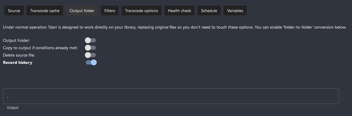

  4. I have experience setting up TDarr on Windows but i have recently setup an UNRAID NAS with an Intel GPU - Everything seems to be going swimmingly and I even got the GPU to work. However all my test runs end up with the transcoded files sitting in the cache forever, never overwriting the source. My config is as follows: /media/test -> Has a test h264 file in it, otherwise library will eventually be /media/tv and /media/movies. /media/ was added as a destination when creating the docker. The tdarr library setup hasn't got any changes to the default output folder: I've tried: Set the PUID of the docker to 1000, which I assume changes the user in case of issues with file permissions I've tried making sure that /media/test/* have read/write across the board I can't see anything in any logs about errors in tdarr and the transcode finishes without "issue"
