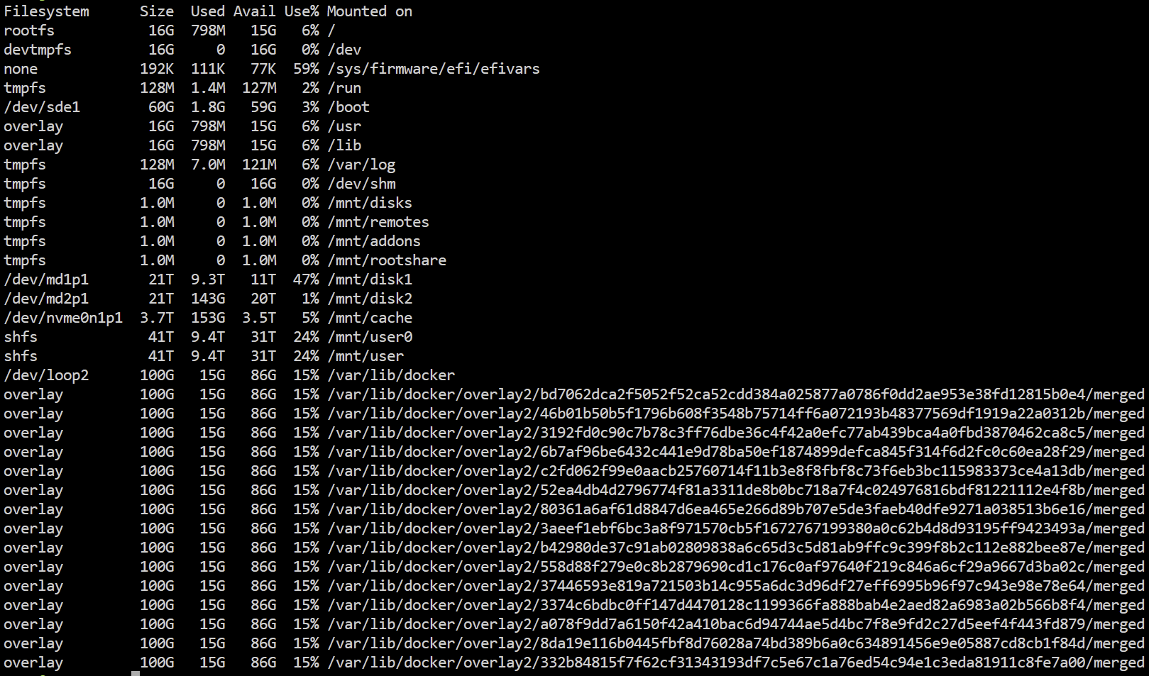

  5. Found a solution. Add a flag to the postgres docker configuration, would solve the Issue. I added it to be a 4G, you can change it to whatever you like. --shm-size=4g

  8. Hello, Unraid Version : 7.2.0 My docker vDisk is 100Gb and out of which only 15GB is being used. But my (and the only one with Issue) docker container : "Immich_PostgreSQL" errors out with : Can someone please help me out to resolve this? All other containers work fine. 2025-11-24 13:05:19.334 EST [270] ERROR: could not resize shared memory segment "/PostgreSQL.4252011740" to 16777216 bytes: No space left on device === Edit (Few more Screenshots) ==== unraid-diagnostics-20251124-1321.zip

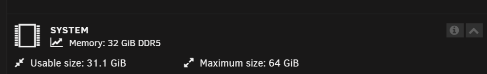

  10. Hello Everyone, I have unRaid server with 64GB of RAM. However It uses only 31.1GB, It does not use the rest. Cam anyone pl. help me In resolving this? I am using unRaid 6.12.6 See screenshots for reference.
  11. Damn it!! I have been on this for past 2 hours, with no luck. Thank you soo much And this solution was not mentioned In any post atleast in first 20 google search. I actually did not know what that meant, so i just left It as is. Can you explain the usecase of that option?

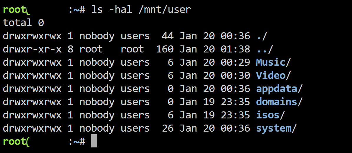

  12. Hello, This is a new setup, started just over a day. I have created 2 shares and both of them are public. Also created a Share user. When i am trying to access those shares using my windows 11 pro (not domain joined) machine and android device, it fails. I tried the following combinations: \\<ip address> - Shows empty folder \\<ip address>\<share-name> - Shows error, unable to access It. I have followed couple different articles on how to resolve the Issue, but none of them are successful. Screenshot of : ls -hal /mnt/User/ Attaching the diagnostic file. == Edit == Removed the diagnostic file as the Issue is resolved.
