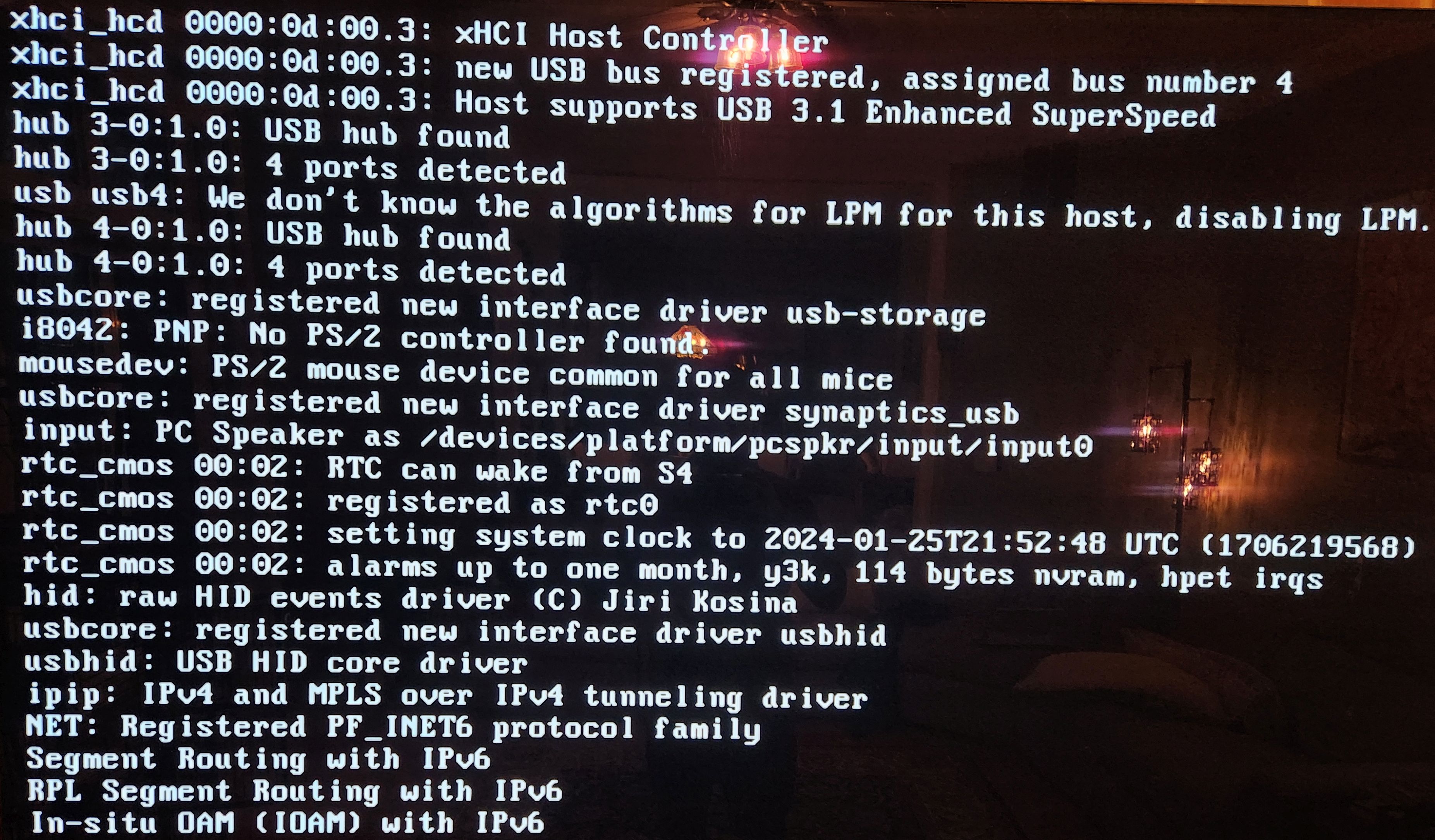

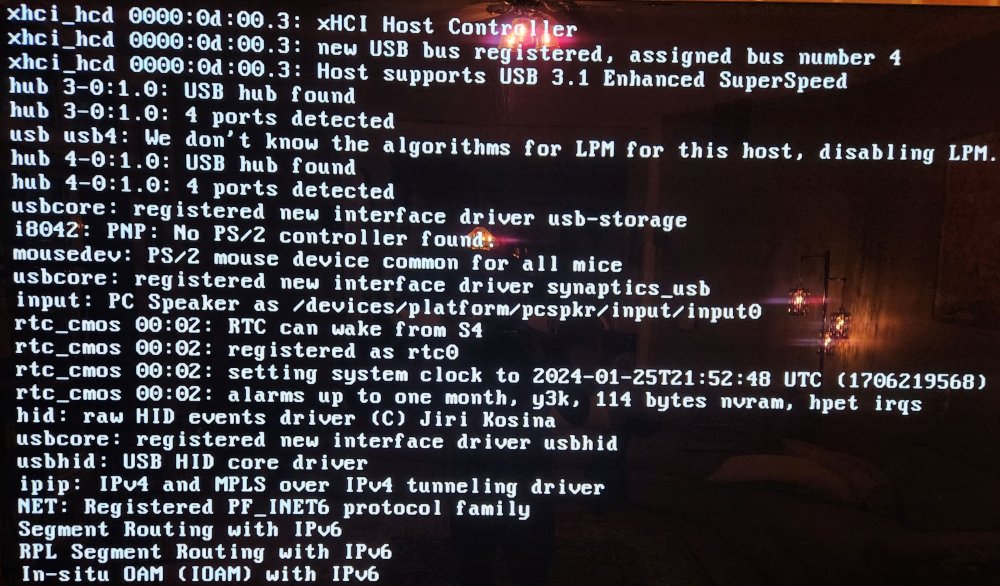

  7. i copied all files, I used winrar so it can clearly tell me which files were corrupted. all was good, so I just formatted the usb and used the usb creation tool and used local zip file. i'm noticing that i'm getting boot error on every reboot, until i format the usb again. i tried chkdsk and also sector read using hard disk sentinel and all is good. something else is going on.
  8. I created a vm and attached nvidia gpu and when i clicked create it stopped responding and the VMs tab tab stopped working completely. after reboot it wont start anymore it got stuck here vfio-pci" vgaarb "deactivate vga console Update 1: I downlaoded all files from the USB and some files were corrupted mostly in: D:\config\pools\ D:\config\docker.cfg I used an older backup to restore those files and reformatted and used local to upload a clean and complete copy (after replacing the corrupted files) Now it passes the ipv6 and stuck in microcode: CPU2: patch_level=0x0a20102b
