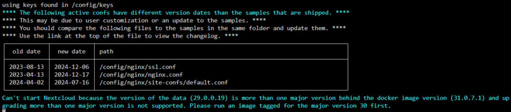

  1. Hi, So I have a problem with my Nextcloud docker image after the Upgrade to Unraid 7 a few weeks ago. Before I upgraded I updated all docker images on the docker page. Then after the upgrade when I wanted to access my nextcloud instance, I could not connect. After checking the logs I saw this message: So after looking for an aswer which I could not find except the one that I saw that in SpaceinvaderOne video "How to Upgrade Nextcloud when using Docker" I saw that he updated the image within the settings of Nextcloud?? Did I needed to update Nextcloud there before upgrading to Unraid 7? Or is there another explanation and solution?
