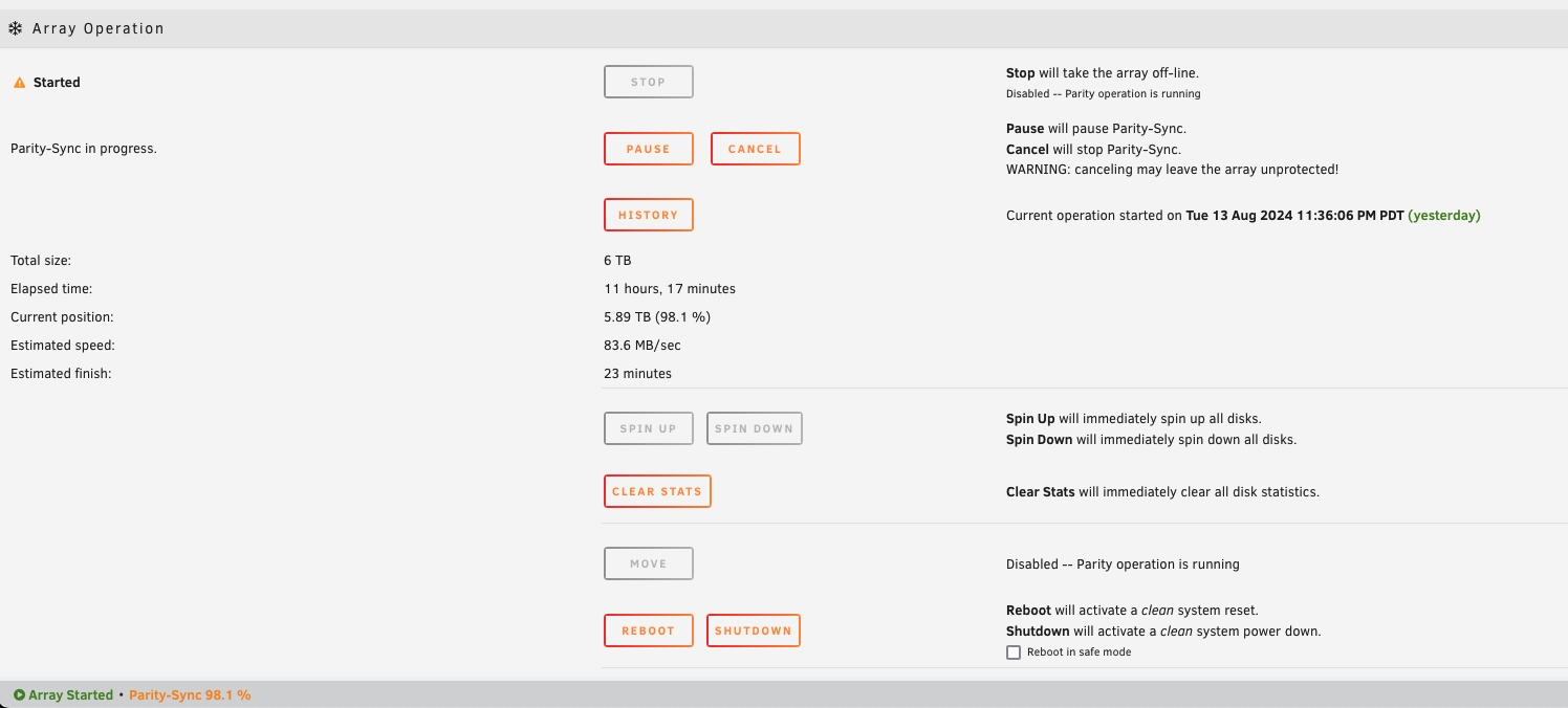

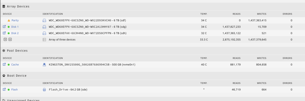

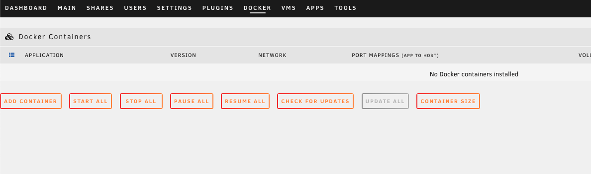

  4. Up until yesterday I was running unraid with two large hard drives, no cache and no parity. I just added another HDD and NVMe and decided to enable parity and cache. Now all of my docker containers have disappeared from the docker tab. Will they come back when the parity check is complete? Is this similar to how turning off the array also stops the docker containers? To be clear, my docker containers haven't turned off, they've completely vanished from the tab. If they have gone missing or been removed for some reason (I swear I didn't do it on purpose) what are the odds that I can restore them with the same configuration as before? Or will I have to rebuild everything from scratch? I had the official plex docker as well as linuxserver's nzbget, sonarr, and radarr installed. Thanks. Screenshots:

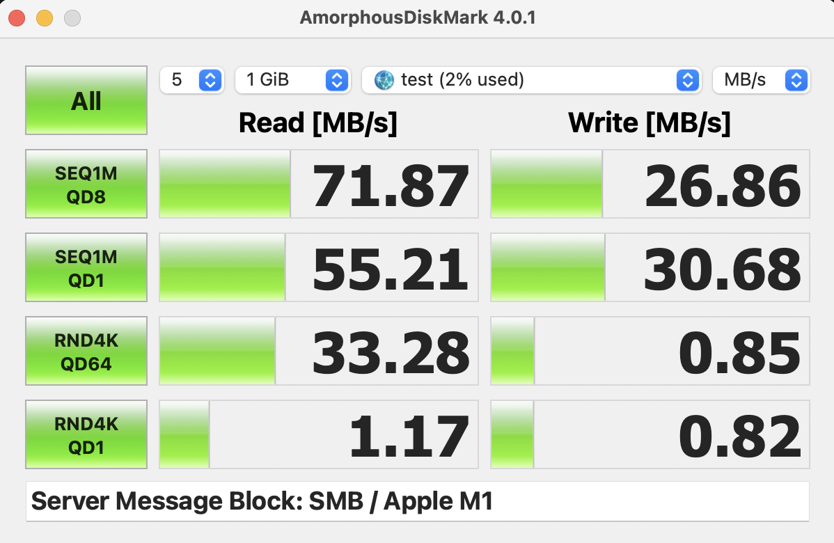

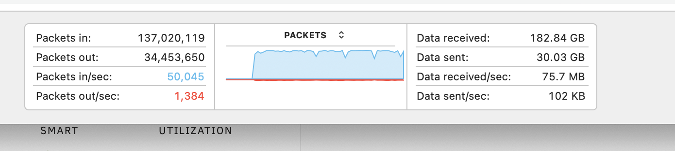

  7. Thanks, I'll check that out. I'll also try this out with my Windows desktop just to check how it performs. Should I expect unraid to be able to saturate a gigabit connection for both reading and writing when using Windows?
  8. Here's the diagnostics. When I copy a file with Finder on my mac, it doesn't show the file transfer speed, but the activity monitor does. Crystal Disk Mark (Or I guess the new one is AmorphousDiskMark?) shows similar stats. I attached some screenshots. Thanks for the reply. vault-diagnostics-20240707-1056.zip
