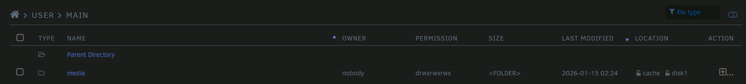

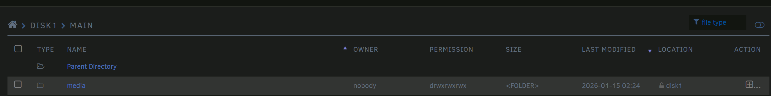

Disk1 is mounted (I saw the filesystem is stated as mounted, in Main->disk1 setting screen), disabled, and emulated, if I'm understanding correctly. Now I installed unassigned devices app and restarted the array with disk1 unassigned. Now I can browse it. Compared to what I can see in Share, it looks like some files/directories are missing. Also there's no lost+found folder.

Sorry for the confusion, maybe my English wasn't good enough Yes, I can see many files and directories exist there. I also noticed that actually many files I can see in Share are actually located at disk 1. I thought it's emulated by parity and not actually referencing disk 1, since disk 1 is still disabled...

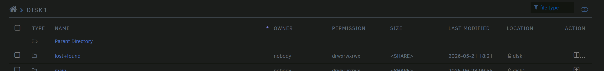

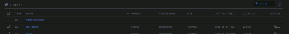

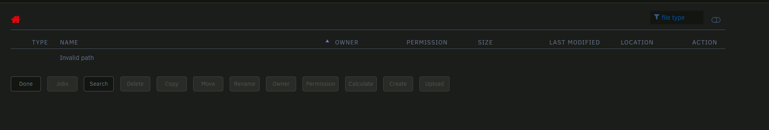

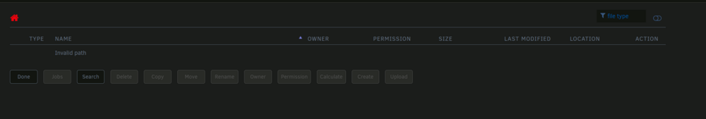

I reboot and check lost+found via Share, but it's still only "Invalid path." tower-diagnostics-20260522-0216.zip

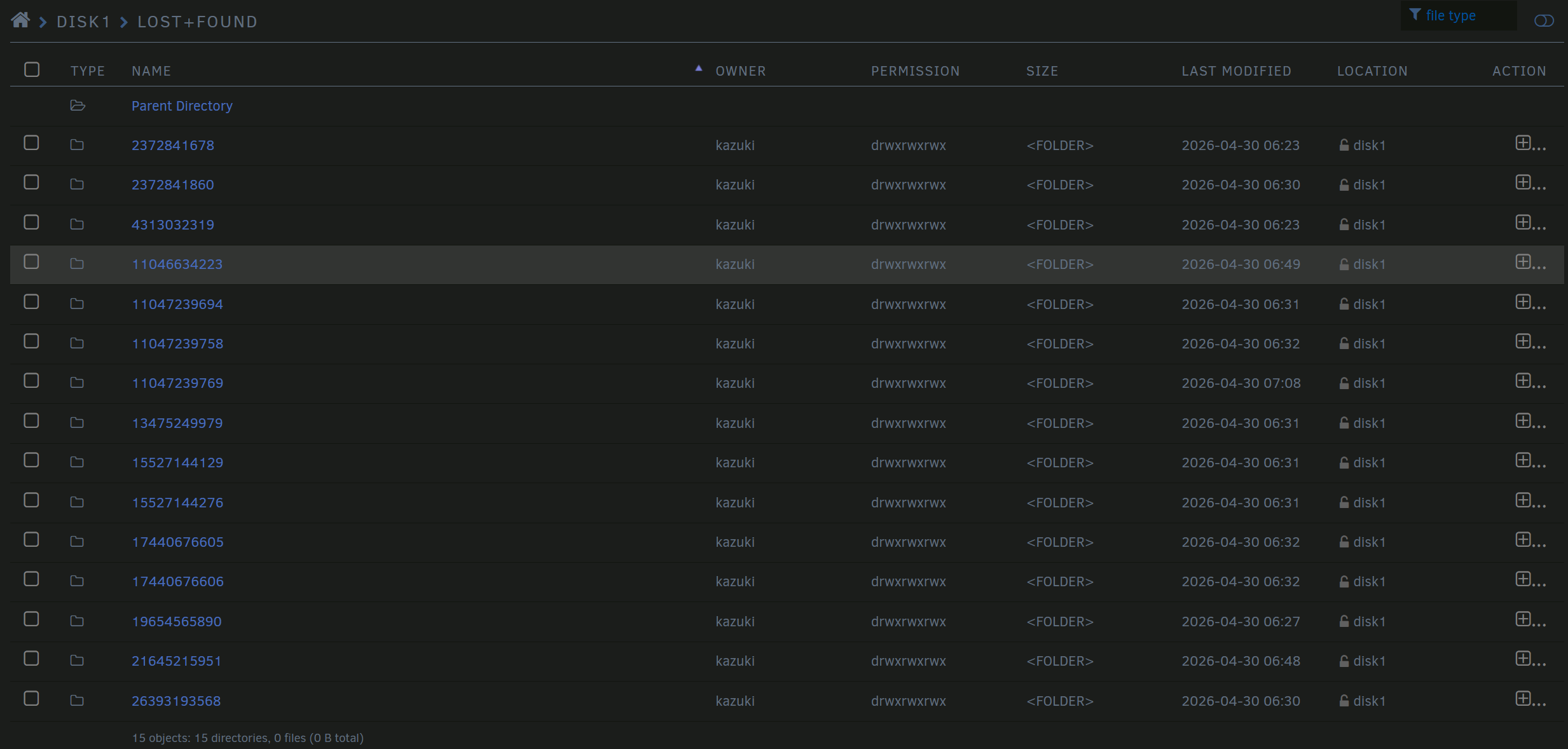

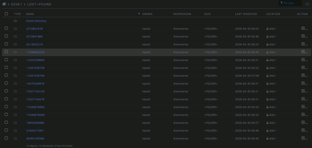

I want to repair every files including the ones that I don't recognize at this point. I can see the files inside lost+found when I browse it via Main -> Disk 1, but when I try to access it via Shares, it's empty or says "Invalid path." Does this mean those specific files are currently not being emulated? If so, should my next step be to get those contents to show up correctly under the lost+found share first?

I found lost+found but there's nothing there... But i can do see there's something in lost+found folder, if I browse it from Main->Disk1. I don't recognize every one of the files in the folders but like half of them were definitely looked familiar... Did I wrong something when i checked lost+found on Share?

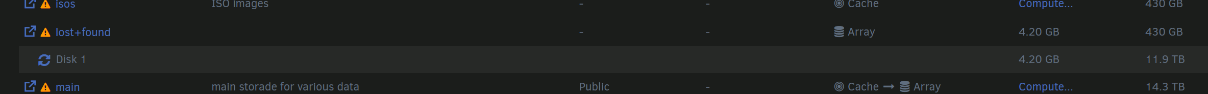

I checked the filesystem of disk 1 and fixed it. (I had to clear log stuff) After that, it showed something like "no corruption on the filesystem". (sorry i didn't save the exact message somewhere) Then I stopped array and restarted without maintenance mode. Now I guess I can see everything I can remember on share! But disk 1 is still disabled. I really appreciate you and glad that at least my data is not lost. Now, what should i do next? (diags is taken after the array restarted) tower-diagnostics-20260521-2011 (1).zip

Here's a new diags. I can see folders in my share now. But I think not all of the share is restored, and disk 1 is still disabled. Because the free space of disks other than disk 1 is mostly unused, I believe most (or probably all?) of the data is stored in disk1. Is there any way to restore the date from disk1? tower-diagnostics-20260520-0741.zip
