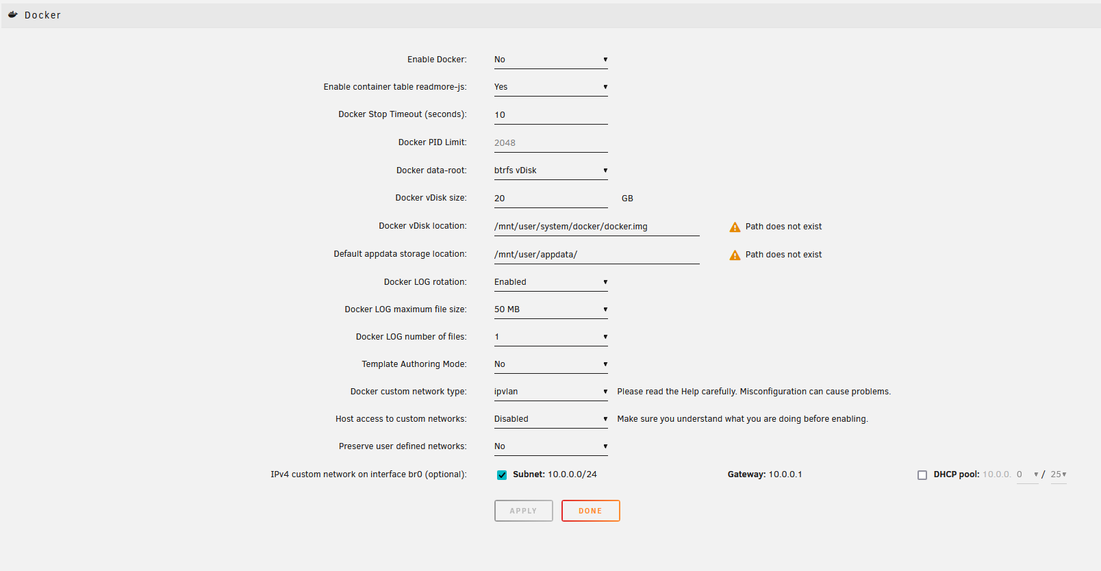

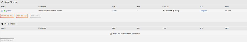

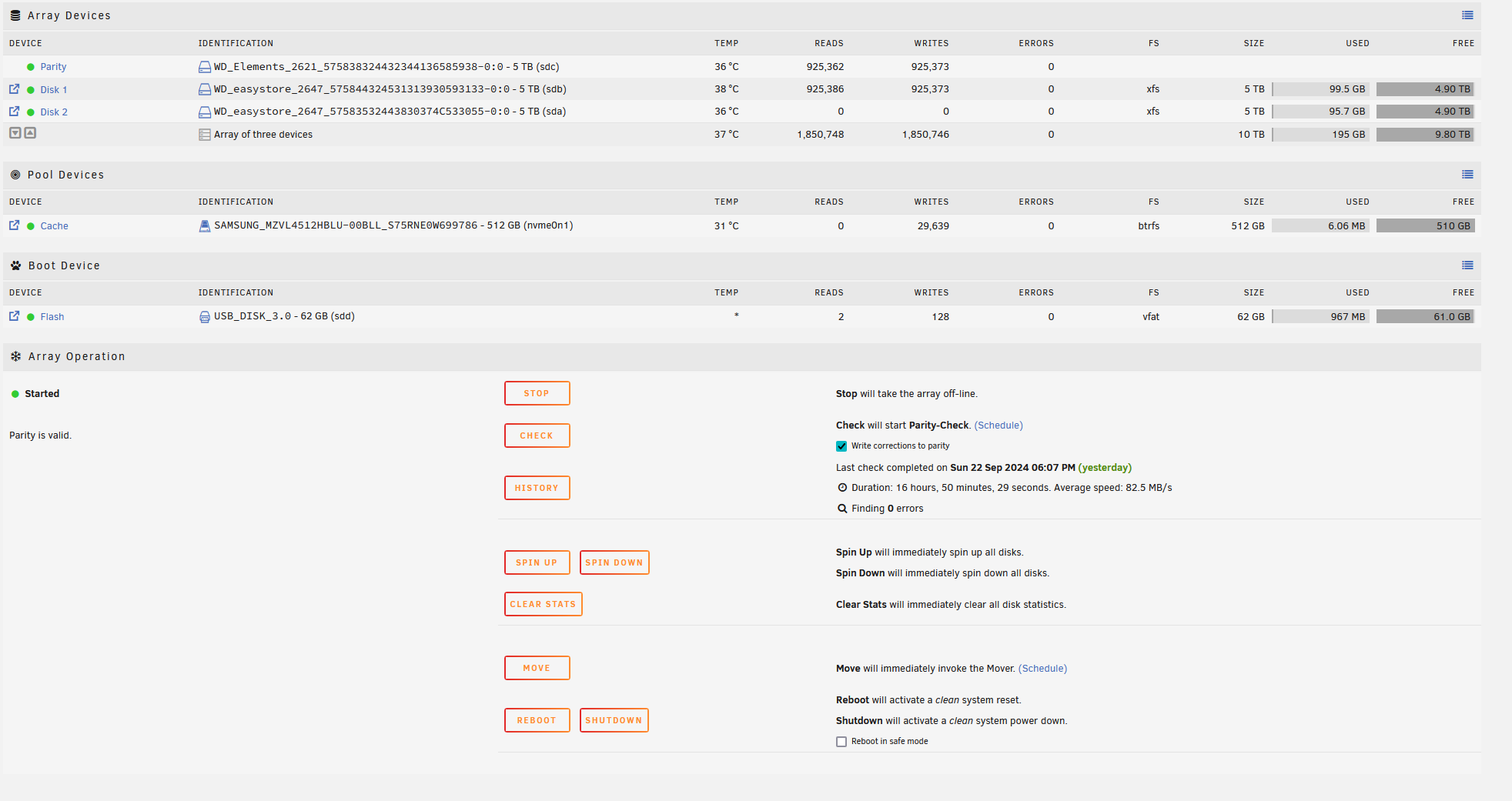

  1. HAHAHAH! It works now. So when I originally had the issue the service was already enabled by default. I had tried disabling it and re-enabling it a few times after making some changes and I was getting the same issue. After the last reboot that made the VM shares show up, I did not enable the docker service before or after the reboot simply because the shares were not there so figured it didn't matter. Apparently I was wrong. I guess it makes sense that I would need to docker services enabled to have it recreate the shares after that last reboot. Appreciate the help but now everything is up and running, got movers scheduled and already have files moving onto the array. Next stop docker town.
  2. I'm attaching an updated diagnostics file that was taken after the reboot and the VM shares were automatically created. Still can't seem to figure out the docker portion. udon-diagnostics-20240923-1505.zip

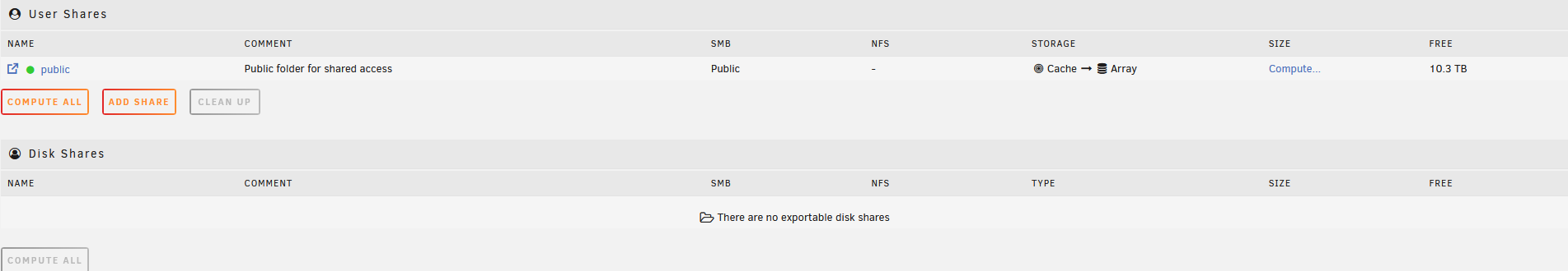

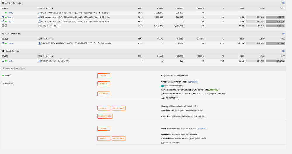

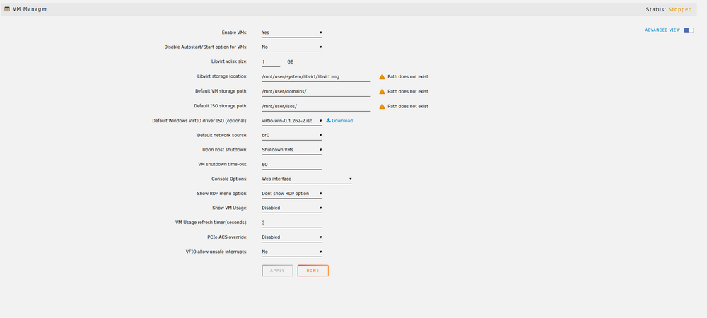

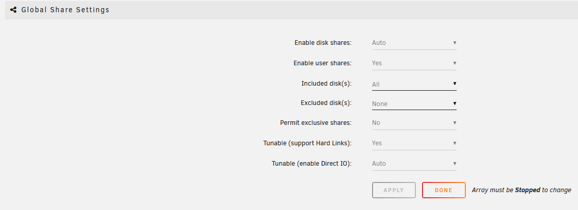

  3. krakkn changed their profile photo
