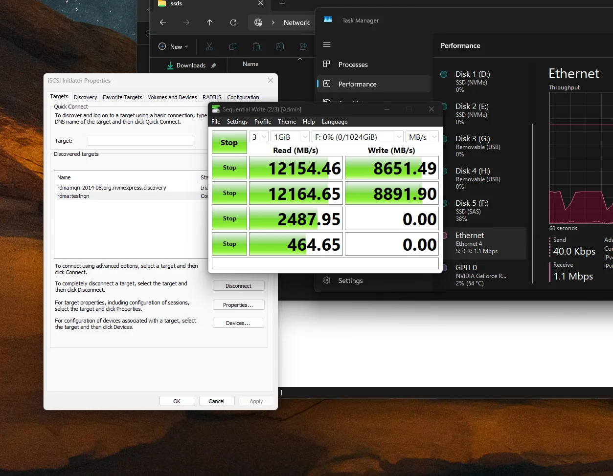

Underwhelming ice driver performance for Intel Ethernet Network Adapter E810-XXVDA2 25gbps NIC
I have a U.2 flash server of 24 NVME drives and use RDMA to access its storage. It is similar to iSCSI so you mount it as a block storage. I am able to max out my 100gbps network. Remember that your switch has to support RDMA too. I attached an image a while back which I also posted on Reddit about how I was able to saturate my 100gbps link with RDMA and Truenas Scale. That was before I could build the RDMA modules for Unraid.
