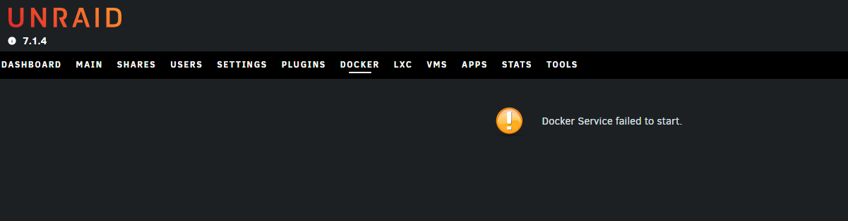

  1. Unfortunately I am not able to do that as the Docker service will not start.
  2. Good morning/afternoon. I woke up this morning and noticed that most of my docker containers had stopped. When I attempted to restart the containers i received the error Docker Execution Error: Error Code 403. So I decided to reboot Unraid. After the restart the Docker service failed to start and will not come up. I do not even know where to start troubleshooting. I have attached the diag file if anyone has the time to look. Any guidance/help would be greatly appreciated. unmccoy2-diagnostics-20250710-0836.zip
