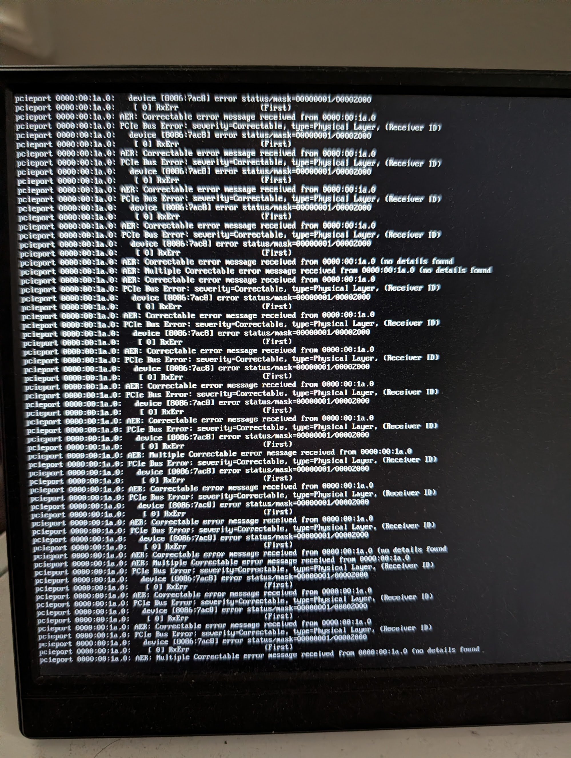

  1. So I had an issue where the Unraid server was still running, Plex was still active and VMs were still accessible. But I could not log in to the Unraid GUI or get a visual readout on a monitor plugged into the server. So I tried a soft reboot just pressing the power button, nothing. So unfortunately my only option was to do a hard reboot with a power long press. Now I keep getting this readout when trying to boot into Unraid. Everything seems to go fine until this The unclean reboot did not create a diagnostics file so this is all I have to go on

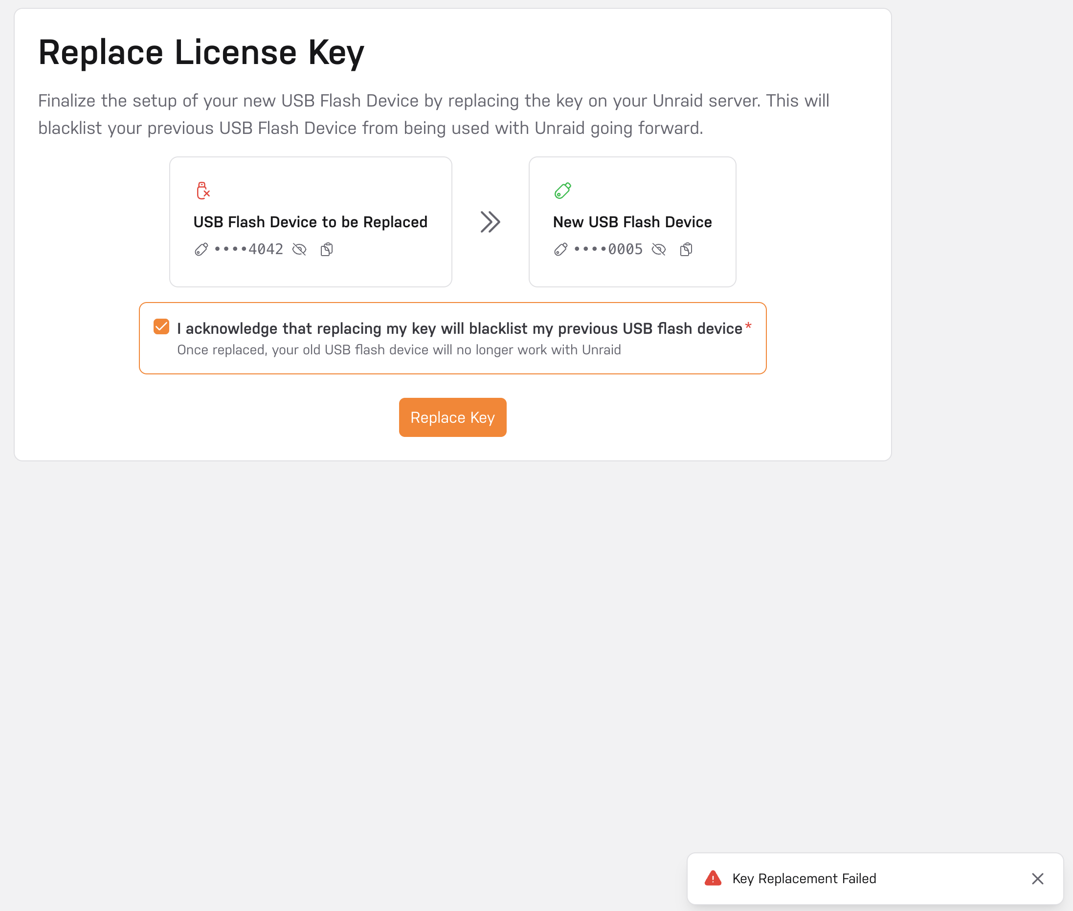

  2. Hi I just had to restore my flash usb with an old backup, using a new usb stick When I boot up, it says I have to replace the key for this new drive but when I try, it always fails. Attached is the screen shot. Could something have happened to my key? m
  3. Ok, So a bit of progress. I found a very old usb flash backup and tried to flash the usb from that. At least this did not cause any rebooting. But I got into the GUI and it says the key is tied to another usb, When I try to replace the key it just keeps saying "key replacement failed" I am starting to think there is something wrong with the key itself and not the file. Is this a thing?
  4. So I Tried your instructions. just copying over the files/folders you suggested. It had the same problems So I started eliminating items one by one. Re flashing the usb each time. All kept failing. I just tried the bare minimum as I don't think anything else will work to recover. I updated only the lines of the ident that were in the stock ident. And I just added the key files. And it goes to the same problem. So I think I may have a corrupt Key file. how would I fix this?

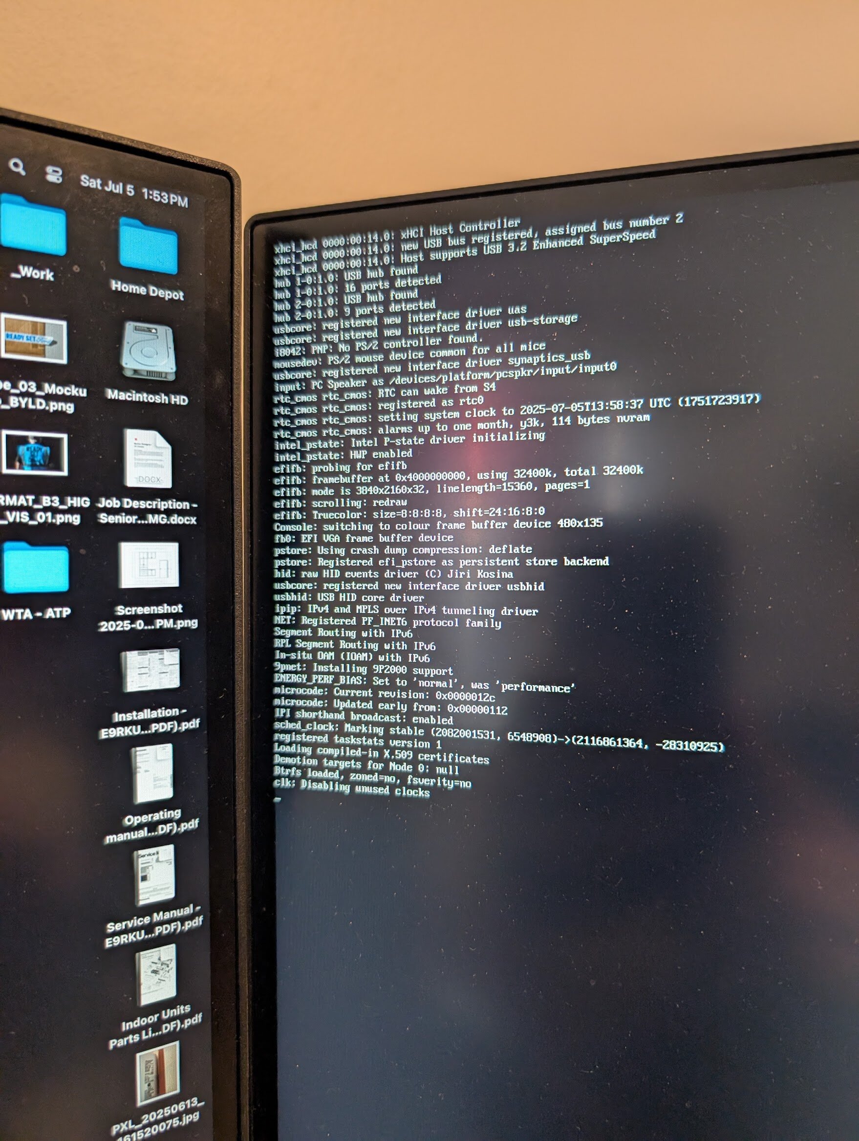

  11. @JorgeB what will happen to my setup. Will I lose everything (data, settings, etc)?
  12. Hi, I have a new issue with booting unraid. Every time I try to boot, everything runs fine until the script starts and it just stops. The last line always being "clk: Disabling unused clocks" I have attached a screenshot of the boot I have tried everything. running in safe mode Replacing bz files Enabling/disabling Fast boot Enabling/disabling XMP Enabling/disabling amount of cores used (from 1 to 14) Enabling/disabling VM support Tried a boot drive of Ubuntu, It works fine Swapped out the memory Swapped out the Motherboard Didn't have a spare cpu on hand, so couldn't test that. Gone through all troubleshooting for both sets of Memory & Motherboard I also just tried a brand new USB from a usb flash backup I had after updating to 7.0 Exactly the same thing. Really running out of things this could be Please help
