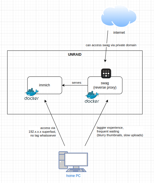

  1. I found what the problem was: unraid and my PC are on a different VLAN, with inter-VLAN traffic blocked. my PC was allowed to VLAN-hop to unraid, but not the other way around. I added an exception that unraid is also allowed to hop back to my PC and now the direct connection is established. Thanks for the help everyone.
  2. When doing tailscale netcheck swag I get the following output: UDP: true IPv4: yes IPv6: no, but OS has support MappingVariesByDestIP: false PortMapping: According to the tailscale https://tailscale.com/kb/1411/device-connectivity documentation, when PortMapping doesn't either return UPnP, NAT-PMP or PCP, getting a direct connection might be difficult. However, a netcheck on my unraid server gives back the same values, and that does get a direct connection. Is some kind of port forwarding or other config needed in the swag container so unraid knows how to properly handle the connections?
  3. I do have a public IP address. Strangely enough my connection to myunraid.tailnet.stuff is direct (according to tailscale status), but the connection to swag running on unraid itself is relayed. So maybe the problem lies with some unraid/swag config setting after all? My swag container uses the following settings: network type: proxynet (a net I made cause I was following a spaceinvaderone video, I have no idea what it actually does) use Tailscale: yes Be a Tailscale exit node: no Tailscale Userspace Networking: Enabled Enable Tailscale SSH: no Tailscale serve: no advanced settings: all default On the recommendation of tailscale config, I added a port-forwarding rule on my ISP's modem to forward port 41641 to my unraid server. If I disable that rule, the unraid server also gets relayed. Maybe I need to add another rule to also port forward my swag ports themselves on the same IP as my unraid server? I don't know if that makes sense, nor if it is wise to be doing port forwarding. Wouldn't want to expose myself unnessarily. I'm seeing the following tailscale behaviour when I did a couple tests: from my PC: tailscale ping unraid -> direct connection from my PC: tailscale ping swag -> relayed connection from unraid: tailscale ping swag -> direct connection
  4. I can't find any info on what my local ISP does, but I suspect I'm not behind CGNAT.
  5. When doing tailscale status on my PC, it says that it's using a relay (even though the machine it's looking for is on the same LAN). Pretty bizarre, but gonna try to figure it out. It's probably not a swag problem like I originally thought. Thanks for the tips.
  6. Maybe it really does have something to do with tailscale itself. On my phone (still on my local LAN) I get the feeling I don't get the slowdown/fuzzy thumbnail lag when going through tailscale/the immich app. So maybe the problem is my PC itself. I still get the problem when I disable tailscale dns on my PC, so that's not it per se. Maybe I should re-ask this question over at tailscale instead of here. I dunno. I still find it weird that traceroute doesn't clearly resolve when I give my domain, whilst I know I can access the swag which is behind the domain, so it does resolve. Thanks for the tips so far.
