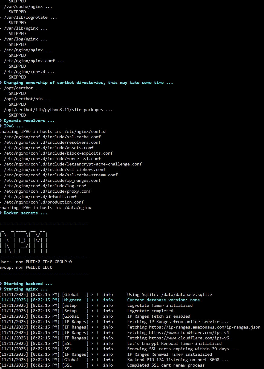

  1. NPM has port 4443 and 8080. I did not change any setting and this config worked now for 2 years. I also tried to give NPM a custom IP with the same result. Edit: Reinstalled NPM one more time and gave it again a custom IP. Had to reconfigure NPM from scratch and most of my services are available again. Still have no clue why NPM stopped working on port 8080 and 4443, worked fine for several years before the update. Still can't figure out the issue with MariaDB docker inspect MariaDB-Official [ { "Id": "2ae28fea65f87b614c7f18030e47f7675c2788fd8d05f2be88516e4765f0137d", "Created": "2025-11-11T20:00:46.09231262Z", "Path": "docker-entrypoint.sh", "Args": [ "mariadbd" ], "State": { "Status": "running", "Running": true, "Paused": false, "Restarting": false, "OOMKilled": false, "Dead": false, "Pid": 56268, "ExitCode": 0, "Error": "", "StartedAt": "2025-11-11T21:47:39.692433687Z", "FinishedAt": "2025-11-11T21:42:07.765832246Z" }, "Image": "sha256:deb0cc780631eacd1580d12879c9b705abd41afb7a2c90a0e7d3b9beba3f046b", "ResolvConfPath": "/var/lib/docker/containers/2ae28fea65f87b614c7f18030e47f7675c2788fd8d05f2be88516e4765f0137d/resolv.conf", "HostnamePath": "/var/lib/docker/containers/2ae28fea65f87b614c7f18030e47f7675c2788fd8d05f2be88516e4765f0137d/hostname", "HostsPath": "/var/lib/docker/containers/2ae28fea65f87b614c7f18030e47f7675c2788fd8d05f2be88516e4765f0137d/hosts", "LogPath": "/var/lib/docker/containers/2ae28fea65f87b614c7f18030e47f7675c2788fd8d05f2be88516e4765f0137d/2ae28fea65f87b614c7f18030e47f7675c2788fd8d05f2be88516e4765f0137d-json.log", "Name": "/MariaDB-Official", "RestartCount": 0, "Driver": "zfs", "Platform": "linux", "MountLabel": "", "ProcessLabel": "", "AppArmorProfile": "", "ExecIDs": null, "HostConfig": { "Binds": [ "/mnt/user/appdata/mariadb-official/data:/var/lib/mysql:rw", "/mnt/user/appdata/mariadb-official/config:/etc/mysql/conf.d:rw" ], "ContainerIDFile": "", "LogConfig": { "Type": "json-file", "Config": { "max-file": "2", "max-size": "100m" } }, "NetworkMode": "bridge", "PortBindings": { "3306/tcp": [ { "HostIp": "", "HostPort": "3306" } ] }, "RestartPolicy": { "Name": "no", "MaximumRetryCount": 0 }, "AutoRemove": false, "VolumeDriver": "", "VolumesFrom": null, "ConsoleSize": [ 0, 0 ], "CapAdd": null, "CapDrop": null, "CgroupnsMode": "private", "Dns": [], "DnsOptions": [], "DnsSearch": [], "ExtraHosts": null, "GroupAdd": null, "IpcMode": "private", "Cgroup": "", "Links": null, "OomScoreAdj": 0, "PidMode": "", "Privileged": false, "PublishAllPorts": false, "ReadonlyRootfs": false, "SecurityOpt": null, "UTSMode": "", "UsernsMode": "", "ShmSize": 67108864, "Runtime": "runc", "Isolation": "", "CpuShares": 0, "Memory": 2147483648, "NanoCpus": 0, "CgroupParent": "", "BlkioWeight": 0, "BlkioWeightDevice": [], "BlkioDeviceReadBps": [], "BlkioDeviceWriteBps": [], "BlkioDeviceReadIOps": [], "BlkioDeviceWriteIOps": [], "CpuPeriod": 0, "CpuQuota": 0, "CpuRealtimePeriod": 0, "CpuRealtimeRuntime": 0, "CpusetCpus": "", "CpusetMems": "", "Devices": [], "DeviceCgroupRules": null, "DeviceRequests": null, "MemoryReservation": 0, "MemorySwap": -1, "MemorySwappiness": null, "OomKillDisable": null, "PidsLimit": 2048, "Ulimits": [], "CpuCount": 0, "CpuPercent": 0, "IOMaximumIOps": 0, "IOMaximumBandwidth": 0, "MaskedPaths": [ "/proc/asound", "/proc/acpi", "/proc/kcore", "/proc/keys", "/proc/latency_stats", "/proc/timer_list", "/proc/timer_stats", "/proc/sched_debug", "/proc/scsi", "/sys/firmware", "/sys/devices/virtual/powercap" ], "ReadonlyPaths": [ "/proc/bus", "/proc/fs", "/proc/irq", "/proc/sys", "/proc/sysrq-trigger" ] }, "GraphDriver": { "Data": { "Dataset": "cache/system/734ab6c0a3c223b8b67c0e6f54e383cdb4b1092dcccc2608d794f77e28379c60", "Mountpoint": "/var/lib/docker/zfs/graph/734ab6c0a3c223b8b67c0e6f54e383cdb4b1092dcccc2608d794f77e28379c60" }, "Name": "zfs" }, "Mounts": [ { "Type": "bind", "Source": "/mnt/user/appdata/mariadb-official/config", "Destination": "/etc/mysql/conf.d", "Mode": "rw", "RW": true, "Propagation": "rprivate" }, { "Type": "bind", "Source": "/mnt/user/appdata/mariadb-official/data", "Destination": "/var/lib/mysql", "Mode": "rw", "RW": true, "Propagation": "rprivate" } ], "Config": { "Hostname": "2ae28fea65f8", "Domainname": "", "User": "99:100", "AttachStdin": false, "AttachStdout": false, "AttachStderr": false, "ExposedPorts": { "3306/tcp": {} }, "Tty": false, "OpenStdin": false, "StdinOnce": false, "Env": [ "HOST_OS=Unraid", "HOST_HOSTNAME=Vault", "HOST_CONTAINERNAME=MariaDB-Official", "MARIADB_DATABASE=next_db", "MARIADB_USER=next", "MARIADB_ROOT_PASSWORD=", "TZ=Europe/Berlin", "MARIADB_RANDOM_ROOT_PASSWORD=Yes", "MARIADB_PASSWORD=Lm15Lo7a+{hy", "PATH=/usr/local/sbin:/usr/local/bin:/usr/sbin:/usr/bin:/sbin:/bin", "container=oci", "GOSU_VERSION=1.19", "MARIADB_VERSION=11.4.9" ], "Cmd": [ "mariadbd" ], "Image": "mariadb:11.4-ubi", "Volumes": { "/var/lib/mysql": {} }, "WorkingDir": "/", "Entrypoint": [ "docker-entrypoint.sh" ], "OnBuild": null, "Labels": { "architecture": "x86_64", "build-date": "2025-10-15T08:06:12Z", "com.redhat.component": "ubi9-minimal-container", "com.redhat.license_terms": "https://www.redhat.com/en/about/red-hat-end-user-license-agreements#UBI", "cpe": "cpe:/a:redhat:enterprise_linux:9::appstream", "description": "MariaDB Database for relational SQL", "distribution-scope": "public", "io.buildah.version": "1.41.4", "io.k8s.description": "The Universal Base Image Minimal is a stripped down image that uses microdnf as a package manager. This base image is freely redistributable, but Red Hat only supports Red Hat technologies through subscriptions for Red Hat products. This image is maintained by Red Hat and updated regularly.", "io.k8s.display-name": "Red Hat Universal Base Image 9 Minimal", "io.openshift.expose-services": "", "io.openshift.tags": "minimal rhel9", "maintainer": "Red Hat, Inc.", "name": "MariaDB Server", "net.unraid.docker.icon": "https://github.com/mgutt/unraid-docker-templates/raw/main/mgutt/images/mariadb.png", "net.unraid.docker.managed": "dockerman", "org.opencontainers.image.authors": "MariaDB Community", "org.opencontainers.image.base.name": "docker.io/redhat/ubi9-minimal", "org.opencontainers.image.description": "MariaDB Database for relational SQL", "org.opencontainers.image.documentation": "https://hub.docker.com/_/mariadb/", "org.opencontainers.image.licenses": "GPL-2.0", "org.opencontainers.image.revision": "d1b15a34ce69ea214e1d32f1f501304f6b8b8c59", "org.opencontainers.image.source": "https://github.com/MariaDB/mariadb-docker", "org.opencontainers.image.title": "MariaDB Database", "org.opencontainers.image.url": "https://github.com/MariaDB/mariadb-docker", "org.opencontainers.image.vendor": "MariaDB Community", "org.opencontainers.image.version": "11.4.9", "release": "Refer to Annotations org.opencontainers.image.{revision,source}", "summary": "MariaDB Database", "url": "https://catalog.redhat.com/en/search?searchType=containers", "vcs-ref": "d1b45ce69ea214e1d32f1f501245f6b8b8c59", "vcs-type": "git", "vendor": "MariaDB Community", "version": "11.4.9" } }, "NetworkSettings": { "Bridge": "", "SandboxID": "667257576fb1d0a5104d0849d145645673b7666998c0de758616ab7534a2", "SandboxKey": "/var/run/docker/netns/66724576fb1", "Ports": { "3306/tcp": [ { "HostIp": "0.0.0.0", "HostPort": "3306" }, { "HostIp": "::", "HostPort": "3306" } ] }, "HairpinMode": false, "LinkLocalIPv6Address": "", "LinkLocalIPv6PrefixLen": 0, "SecondaryIPAddresses": null, "SecondaryIPv6Addresses": null, "EndpointID": "1595ca2b51da7018e5b332f524368fca9a5fbcq75f5d5b67bb4711027d17bf9", "Gateway": "172.17.0.1", "GlobalIPv6Address": "", "GlobalIPv6PrefixLen": 0, "IPAddress": "172.17.0.6", "IPPrefixLen": 16, "IPv6Gateway": "", "MacAddress": "02:42:ac:11:XXXX, "Networks": { "bridge": { "IPAMConfig": null, "Links": null, "Aliases": null, "MacAddress": "02:42:ac:11:XXXX", "DriverOpts": null, "NetworkID": "cc47c6ea03029c16da23b844a84d5e289a5e91f4652ca7f76996d64883af8612", "EndpointID": "1595ca2b51da7018e5b332f524368fja9a5fbc87hjf5d5b67bb4711027d17bf9", "Gateway": "172.17.0.1", "IPAddress": "172.17.0.6", "IPPrefixLen": 16, "IPv6Gateway": "", "GlobalIPv6Address": "", "GlobalIPv6PrefixLen": 0, "DNSNames": null } } } } ] Edit: Resolved by installing Nextcloud and MariaDB from scratch... A custom network fixed the NPM issue. Thanks for the help.
  2. Hi thanks for the quick response. I checked the docker advanced settings, I am using Ipvlan because my router cant handle Macvlan. NPM is running in bridge mode. I tried to reinstall in completely from scratch (bridge and custom network) both without success. I also removed adguard completely to be sure that there isn't any dns issue. NPM gets stuck at "migrate" Currently NPM is the only container running unraid is on port 80,443 and the internal port is redirected by the router: docker inspect Nginx-Proxy-Manager-Official [ { "Id": "4dcccc4f65dd613gd9ef52ec768cfaed026a47j4e7689df201bd4d83bc59bfea", "Created": "2025-11-11T18:34:20.58823016Z", "Path": "/init", "Args": [], "State": { "Status": "running", "Running": true, "Paused": false, "Restarting": false, "OOMKilled": false, "Dead": false, "Pid": 14086, "ExitCode": 0, "Error": "", "StartedAt": "2025-11-11T19:02:14.3459529Z", "FinishedAt": "2025-11-11T18:59:46.90245928Z" }, "Image": "sha256:ab42d3ca72337870f0d6c59a4363989cf602e857bf225d67af59f9d1aae1e405", "ResolvConfPath": "/var/lib/docker/containers/4dcccc4f65dd6131d9ef52ec768cfaed026a4774e7k89df201bd4d83bc59bfea/resolv.conf", "HostnamePath": "/var/lib/docker/containers/4dcccc4f65dd6131d9ef52ec768cfaed026a4774e76j9df201bd4d83bc59bfea/hostname", "HostsPath": "/var/lib/docker/containers/4dcccc4f65dd6131d9ef52ec768cfaed026a4774e7h89df201bd4d83bc59bfea/hosts", "LogPath": "/var/lib/docker/containers/4dcccc4f65dd6131d9ef52ec768cfaed026a4774e768jdf201bd4d83bc59bfea/4dcccc4f65dd6131d9ef52ec768cfaed026a4774e7689df201bd4d83bc59bfea-json.log", "Name": "/Nginx-Proxy-Manager-Official", "RestartCount": 0, "Driver": "zfs", "Platform": "linux", "MountLabel": "", "ProcessLabel": "", "AppArmorProfile": "", "ExecIDs": null, "HostConfig": { "Binds": [ "/mnt/user/appdata/Nginx-Proxy-Manager-Official/data:/data:rw", "/mnt/user/appdata/Nginx-Proxy-Manager-Official/letsencrypt:/etc/letsencrypt:rw", "/tmp/Nginx-Proxy-Manager-Official/var/log:/var/log:rw" ], "ContainerIDFile": "", "LogConfig": { "Type": "json-file", "Config": { "max-file": "2", "max-size": "100m" } }, "NetworkMode": "bridge", "PortBindings": { "3000/tcp": [ { "HostIp": "", "HostPort": "3000" } ], "4443/tcp": [ { "HostIp": "", "HostPort": "4443" } ], "8080/tcp": [ { "HostIp": "", "HostPort": "8080" } ], "8181/tcp": [ { "HostIp": "", "HostPort": "8181" } ] }, "RestartPolicy": { "Name": "no", "MaximumRetryCount": 0 }, "AutoRemove": false, "VolumeDriver": "", "VolumesFrom": null, "ConsoleSize": [ 0, 0 ], "CapAdd": null, "CapDrop": null, "CgroupnsMode": "private", "Dns": [], "DnsOptions": [], "DnsSearch": [], "ExtraHosts": null, "GroupAdd": null, "IpcMode": "private", "Cgroup": "", "Links": null, "OomScoreAdj": 0, "PidMode": "", "Privileged": false, "PublishAllPorts": false, "ReadonlyRootfs": false, "SecurityOpt": null, "UTSMode": "", "UsernsMode": "", "ShmSize": 67108864, "Runtime": "runc", "Isolation": "", "CpuShares": 0, "Memory": 1073741824, "NanoCpus": 0, "CgroupParent": "", "BlkioWeight": 0, "BlkioWeightDevice": [], "BlkioDeviceReadBps": [], "BlkioDeviceWriteBps": [], "BlkioDeviceReadIOps": [], "BlkioDeviceWriteIOps": [], "CpuPeriod": 0, "CpuQuota": 0, "CpuRealtimePeriod": 0, "CpuRealtimeRuntime": 0, "CpusetCpus": "", "CpusetMems": "", "Devices": [], "DeviceCgroupRules": null, "DeviceRequests": null, "MemoryReservation": 0, "MemorySwap": -1, "MemorySwappiness": null, "OomKillDisable": null, "PidsLimit": 2048, "Ulimits": [], "CpuCount": 0, "CpuPercent": 0, "IOMaximumIOps": 0, "IOMaximumBandwidth": 0, "MaskedPaths": [ "/proc/asound", "/proc/acpi", "/proc/kcore", "/proc/keys", "/proc/latency_stats", "/proc/timer_list", "/proc/timer_stats", "/proc/sched_debug", "/proc/scsi", "/sys/firmware", "/sys/devices/virtual/powercap" ], "ReadonlyPaths": [ "/proc/bus", "/proc/fs", "/proc/irq", "/proc/sys", "/proc/sysrq-trigger" ] }, "GraphDriver": { "Data": { "Dataset": "cache/system/3f241367e236da8b9ef956268dc1482f529ac7c2c8bf87fc991f9f2b658f0747", "Mountpoint": "/var/lib/docker/zfs/graph/3f241367e236da8b9ef956268dc1482f529ac7c2c8bf87fc991f9f2b658f0747" }, "Name": "zfs" }, "Mounts": [ { "Type": "bind", "Source": "/mnt/user/appdata/Nginx-Proxy-Manager-Official/data", "Destination": "/data", "Mode": "rw", "RW": true, "Propagation": "rprivate" }, { "Type": "bind", "Source": "/mnt/user/appdata/Nginx-Proxy-Manager-Official/letsencrypt", "Destination": "/etc/letsencrypt", "Mode": "rw", "RW": true, "Propagation": "rprivate" }, { "Type": "bind", "Source": "/tmp/Nginx-Proxy-Manager-Official/var/log", "Destination": "/var/log", "Mode": "rw", "RW": true, "Propagation": "rprivate" } ], "Config": { "Hostname": "4dcccc4f65dd", "Domainname": "", "User": "", "AttachStdin": false, "AttachStdout": false, "AttachStderr": false, "ExposedPorts": { "3000/tcp": {}, "443/tcp": {}, "4443/tcp": {}, "80/tcp": {}, "8080/tcp": {}, "81/tcp": {}, "8181/tcp": {} }, "Tty": false, "OpenStdin": false, "StdinOnce": false, "Env": [ "TZ=Europe/Berlin", "HOST_OS=Unraid", "HOST_HOSTNAME=Vault101", "HOST_CONTAINERNAME=Nginx-Proxy-Manager-Official", "DB_SQLITE_FILE=/data/database.sqlite", "PATH=/opt/certbot/bin:/usr/local/sbin:/usr/local/bin:/usr/sbin:/usr/bin:/sbin:/bin", "SSL_CERT_FILE=/etc/ssl/certs/ca-certificates.crt", "OPENRESTY_VERSION=1.27.1.2", "CROWDSEC_OPENRESTY_BOUNCER_VERSION=0.1.7", "CURL_CA_BUNDLE=/etc/ssl/certs/ca-certificates.crt", "SUPPRESS_NO_CONFIG_WARNING=1", "S6_BEHAVIOUR_IF_STAGE2_FAILS=1", "S6_CMD_WAIT_FOR_SERVICES_MAXTIME=0", "S6_FIX_ATTRS_HIDDEN=1", "S6_KILL_FINISH_MAXTIME=10000", "S6_VERBOSITY=1", "NODE_ENV=production", "NPM_BUILD_VERSION=2.13.3", "NPM_BUILD_COMMIT=2578105", "NPM_BUILD_DATE=2025-11-11 07:05:10 UTC", "NODE_OPTIONS=--openssl-legacy-provider" ], "Cmd": null, "Healthcheck": { "Test": [ "NONE" ] }, "Image": "jc21/nginx-proxy-manager", "Volumes": { "/data": {} }, "WorkingDir": "/app", "Entrypoint": [ "/init" ], "OnBuild": null, "Labels": { "maintainer": "Jamie Curnow <[email protected]>", "net.unraid.docker.icon": "https://nginxproxymanager.com/icon.png", "net.unraid.docker.managed": "dockerman", "net.unraid.docker.webui": "http://[IP]:[PORT:8181]", "org.label-schema.cmd": "docker run --rm -ti jc21/nginx-proxy-manager:latest", "org.label-schema.description": "Docker container for managing Nginx proxy hosts with a simple, powerful interface ", "org.label-schema.license": "MIT", "org.label-schema.name": "nginx-proxy-manager", "org.label-schema.schema-version": "1.0", "org.label-schema.url": "https://github.com/jc21/nginx-proxy-manager", "org.label-schema.vcs-url": "https://github.com/jc21/nginx-proxy-manager.git" } }, "NetworkSettings": { "Bridge": "", "SandboxID": "2b560848747ea9267bed9287f055990d3bc8874b9777f51fe0ae759271c327e1", "SandboxKey": "/var/run/docker/netns/2b560848747e", "Ports": { "3000/tcp": [ { "HostIp": "0.0.0.0", "HostPort": "3000" }, { "HostIp": "::", "HostPort": "3000" } ], "443/tcp": null, "4443/tcp": [ { "HostIp": "0.0.0.0", "HostPort": "4443" }, { "HostIp": "::", "HostPort": "4443" } ], "80/tcp": null, "8080/tcp": [ { "HostIp": "0.0.0.0", "HostPort": "8080" }, { "HostIp": "::", "HostPort": "8080" } ], "81/tcp": null, "8181/tcp": [ { "HostIp": "0.0.0.0", "HostPort": "8181" }, { "HostIp": "::", "HostPort": "8181" } ] }, "HairpinMode": false, "LinkLocalIPv6Address": "", "LinkLocalIPv6PrefixLen": 0, "SecondaryIPAddresses": null, "SecondaryIPv6Addresses": null, "EndpointID": "061f1dc4fa99d8f68e8eeb4538293c8dec30949a5e4d395b7373d31dd01cf8f6", "Gateway": "172.17.0.1", "GlobalIPv6Address": "fd17::242:XXXX", "GlobalIPv6PrefixLen": 64, "IPAddress": "172.17.0.3", "IPPrefixLen": 16, "IPv6Gateway": "fd17::1", "MacAddress": "02:42:ac:11:XXX", "Networks": { "bridge": { "IPAMConfig": null, "Links": null, "Aliases": null, "MacAddress": "02:42:ac:11:XXXX, "DriverOpts": null, "NetworkID": "b6d3a02f731766045b9fe09f85e43be0x99862f5168d0e1f77e91e9b996cXXX", "EndpointID": "061f1dc4fa99d8f68e8eeb4868d93c8dec30949a5e4d995b7373d31dd01cfXXX", "Gateway": "172.17.0.1", "IPAddress": "172.17.0.3", "IPPrefixLen": 16, "IPv6Gateway": "fd17::1", "GlobalIPv6Address": "fd17::242:XXXX", "GlobalIPv6PrefixLen": 64, "DNSNames": nullEdit: Also tried to reinstall MariaDB-Official from scratch with only MariaDB running: same result. It runs also in bridge mode and the port is defiantly not in use.
