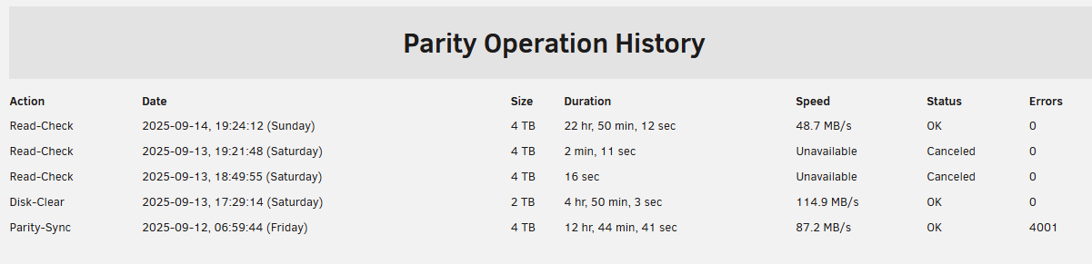

  4. Ah that's a shame - would be nice to have that written to the parity disk as it's only valid when paired with those now-unknown disks :-) Do you think there's only one parity check here? I'm not clear about the "disk-check" items - they're in the "Parity Operation History" so maybe they're a flavour of parity check too? If not it looks like I only actually managed to build it once, so that would have been with all three of the original three data disks and I'll need at least two in place to rebuild from.
