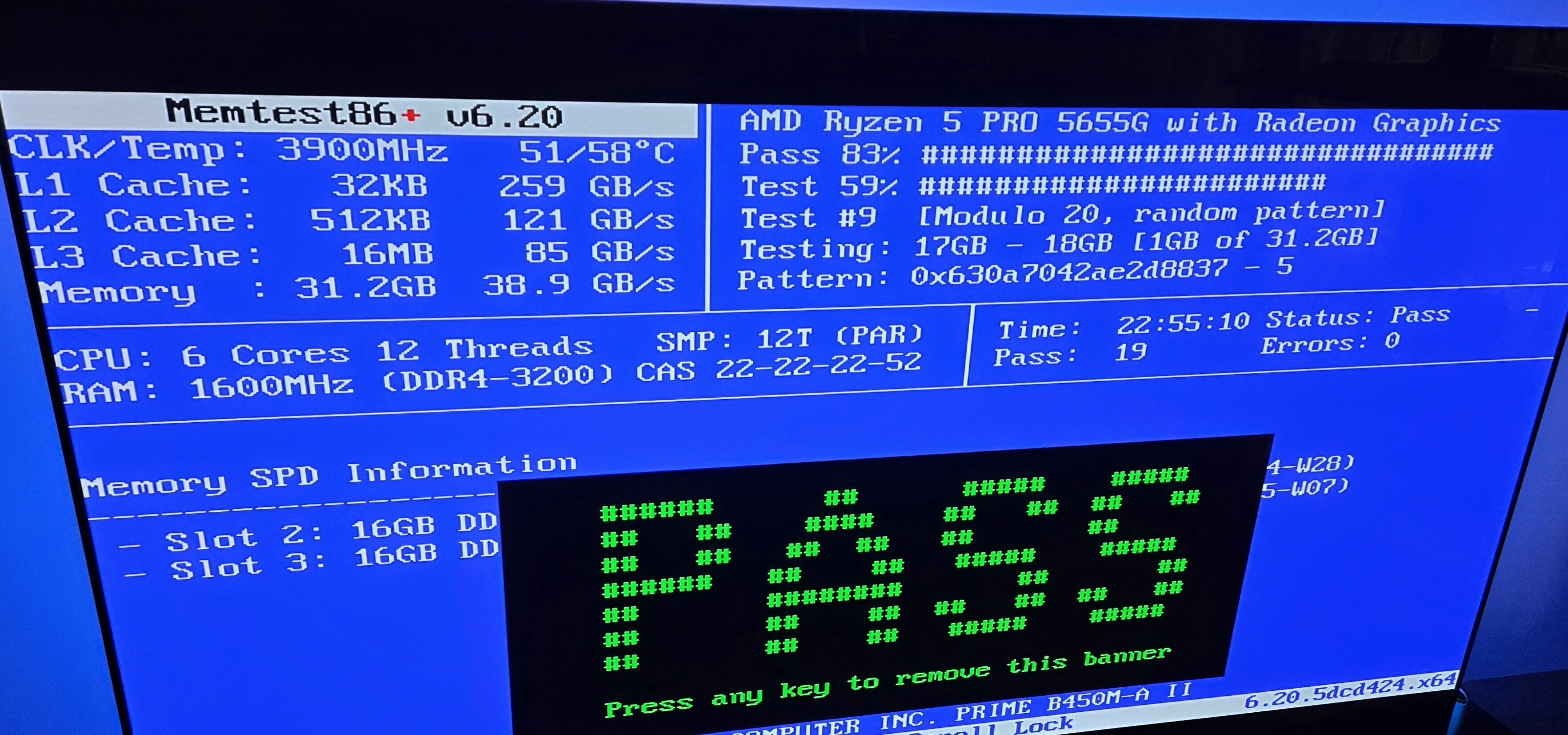

  2. New cables finally arrived after delay. Parity is currently running with all drives connected through hbas. I ended up doing a memtest but found no errors. So here's hoping it's the motherboard lol. Otherwise the only part left is the cpu but I highly doubt this can be the issue. Also I have no idea why memtest says slot 2 and 3 for my ram they are inserted correctly. (Old photo so no these sata cables aren't there anymore)
