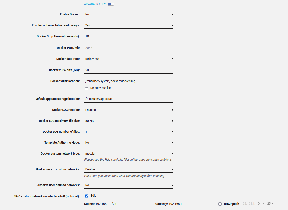

  4. Well, it crashed again with docker setting to ipvlan. I restarted the server disabled bonding and bridging and turned on docker with no containers. Docker is using macvlan since bonding and bridging are turned off. I'm really starting to give up here. I ran memtest and it passed I've run docker in default settings with no containers enabled and it crashed I ran docker in ipvlan with no containers enabled and it crashed. I don't enable docker and the server runs fine. No errors on disks No errors in log files. Attached are the most recent log files. apollo-diagnostics-20260309-1212.zip
  5. Ok, but I will say, that since switching to ipvlan there are no crashes yet. Coming up on 3 hours running ipvlan with one docker enabled using a custom network. Bonding and bridging are still enabled. Does anyone have theories as to why having docker use macvlan would cause a crash?

  8. Small update, the one thing I hadn't tried was switching from macvlan to ipvlan in docker settings. I did that and enabled docker with containers stopped. So far it has been running smoothly, uptime almost 2 hours.

  10. apollo-diagnostics-20260309-0829.zip
