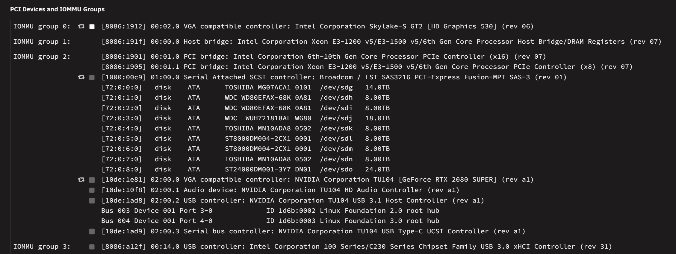

  3. Both answers solved my issue, which required the ACS override option. So far no GPU issues after rebinding the isolated 2080 to vfio. Thanks guys.
  4. Hi all, I have a 2080 GPU that I want to use for VMs. You can see the output of Tools | System Devices in the attached PNG. The 2080 is listed in group 2, but as you can see it's not selectable for binding to vfio at boot. Does this mean the 2080 cannot be passed through? Or anything that affects the system? Do I need to take further steps? Thank you for any hints/pointers.
