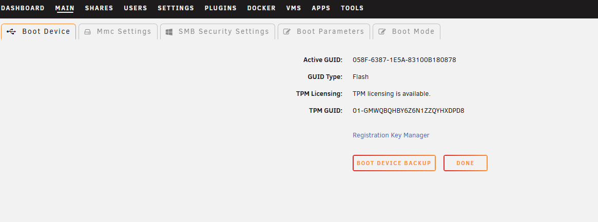

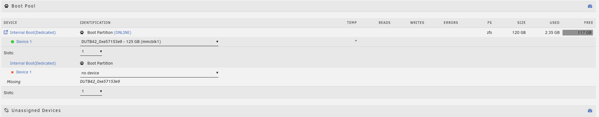

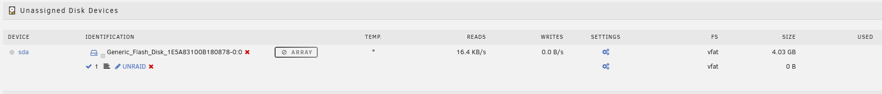

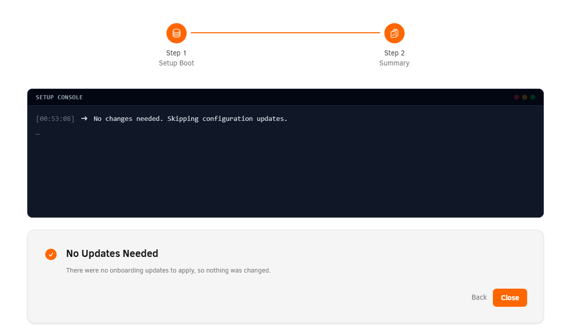

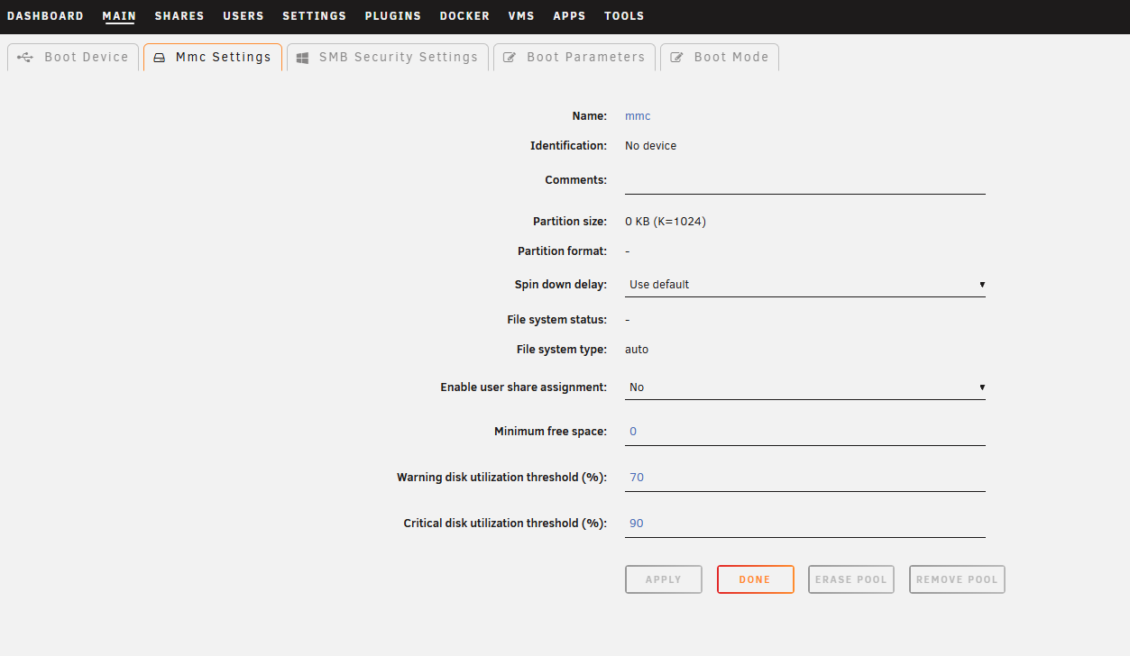

  2. Clicking the second pool does not give me any remove option at first: Going into the second tab, there is indeed a "Remove pool" option, but all greyed out. I have posted the diagnostics in my first post, but here they are again: tower-diagnostics-20260517-0055.zip Thank you!
