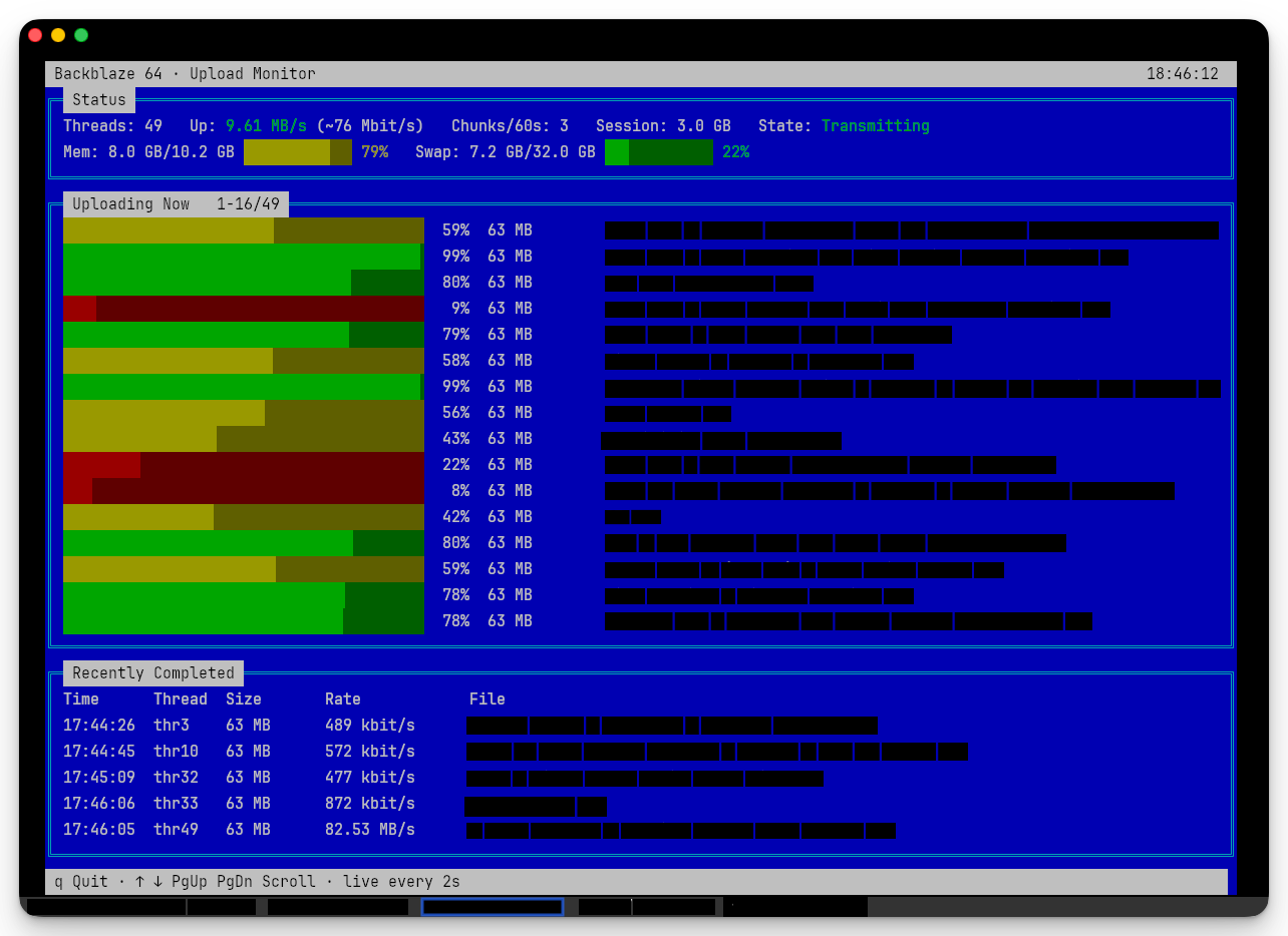

  7. Thanks for confirming. The ten-second idle is the parent process reading the next chunk. Your log from before the change shows the client had sixteen upload slots open, and each child finished its 10 MB chunk in about three seconds, but the parent only handed out a new chunk every two seconds. Before each launch it reads the next 10 MB from the source drive, hashes it and stages it, and two seconds for 10 MB is a 5 MB/s read. However many threads you allow, the parent cannot feed them faster than it can read. Your drives are mapped through /mnt/user, so every read goes through Unraid's shfs layer, and long sequential reads like these are what it is slowest at. Change the container's drive mappings to the disk or pool path underneath, /mnt/cache/share or /mnt/diskN/share rather than /mnt/user/share, and do the same for the temporary drive. That takes shfs out of the read path. Then watch the chunks per minute on the Monitor; the parent's cadence is what should change. Before changing anything, pull :beta again to update to build 236 and run bb-doctor. The Source drives section now reads 64 MB from a large file on each drive and prints the speed, with how many chunks a minute the pass can stage from it. Under 20 MB/s on the drive your big files live on and the mapping should fix it. If it comes out fast, the bottleneck is somewhere else. In this case, if you could give me another diagnostic bundle, I'll investigate further.
