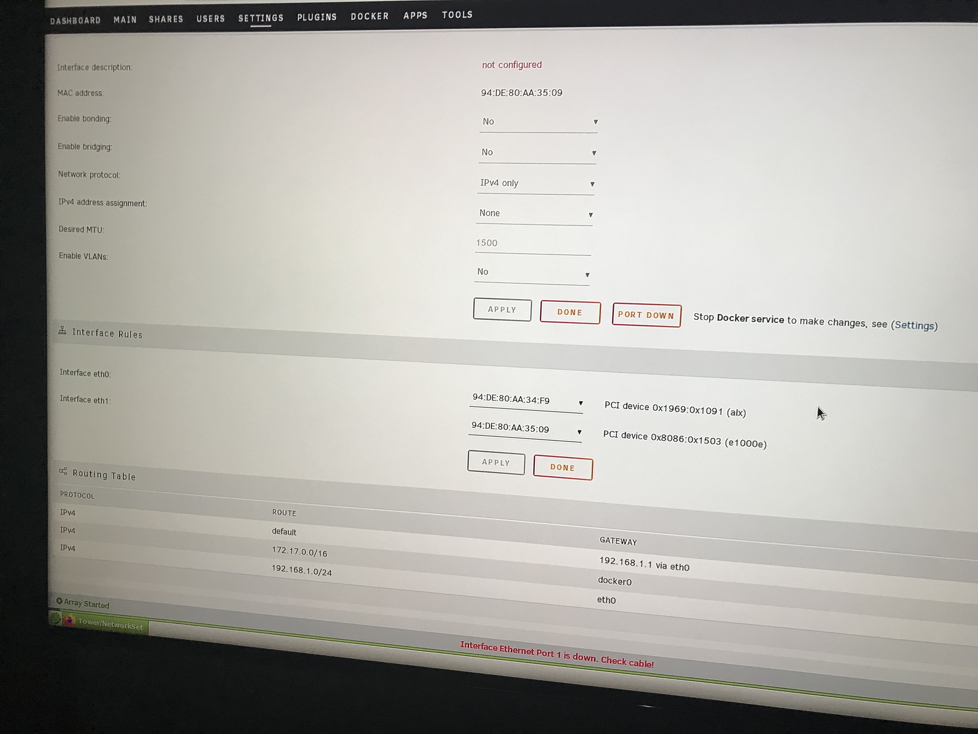

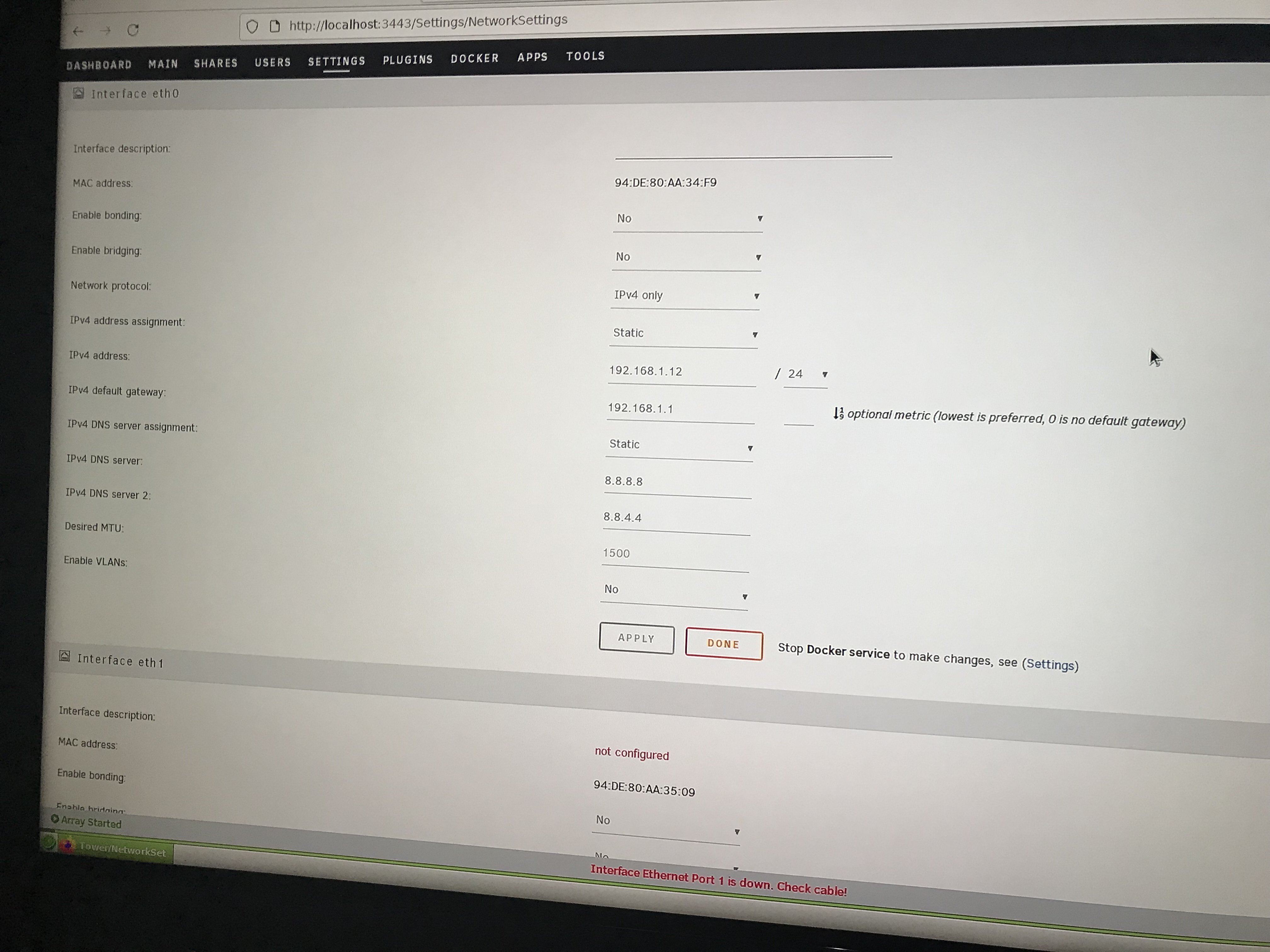

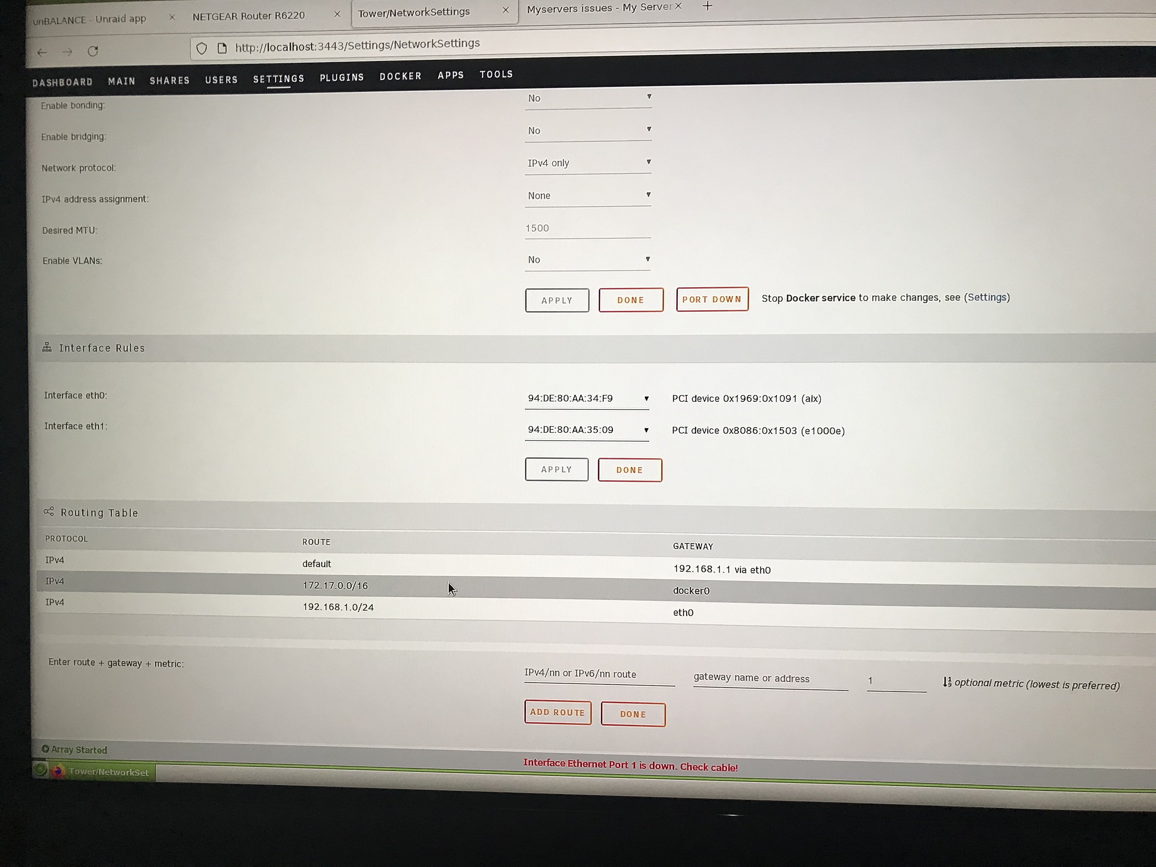

  9. These are some pics of the network settings. Hope they shed some light.
  10. I also noticed that the address for webgui is localhost:3443 not the 192.168.1.12. I tried entering it in safari and sez server not found
  11. In Network setting the the IPv4 address is the 192.168.1.12 then a /24/ I am on the FireFox WebGUI, but I am not able to attache the diagnostic file from server. When I hover over the Choose file, I am not able to navigate to find file on on the unraid server
  12. I did notice that the local access is unlocked and is red. Is that normal? Also I noticed that I am not able to access locally. I am able only access unraid via webgui. I am not able to access via iPad or phone. I used to be able to access by entering 192.168.1.12. But now it will not load.. Could I have done something wrong when i setup the router?
  13. Thanks ljm42 that seems to have fixed it much appreciated
