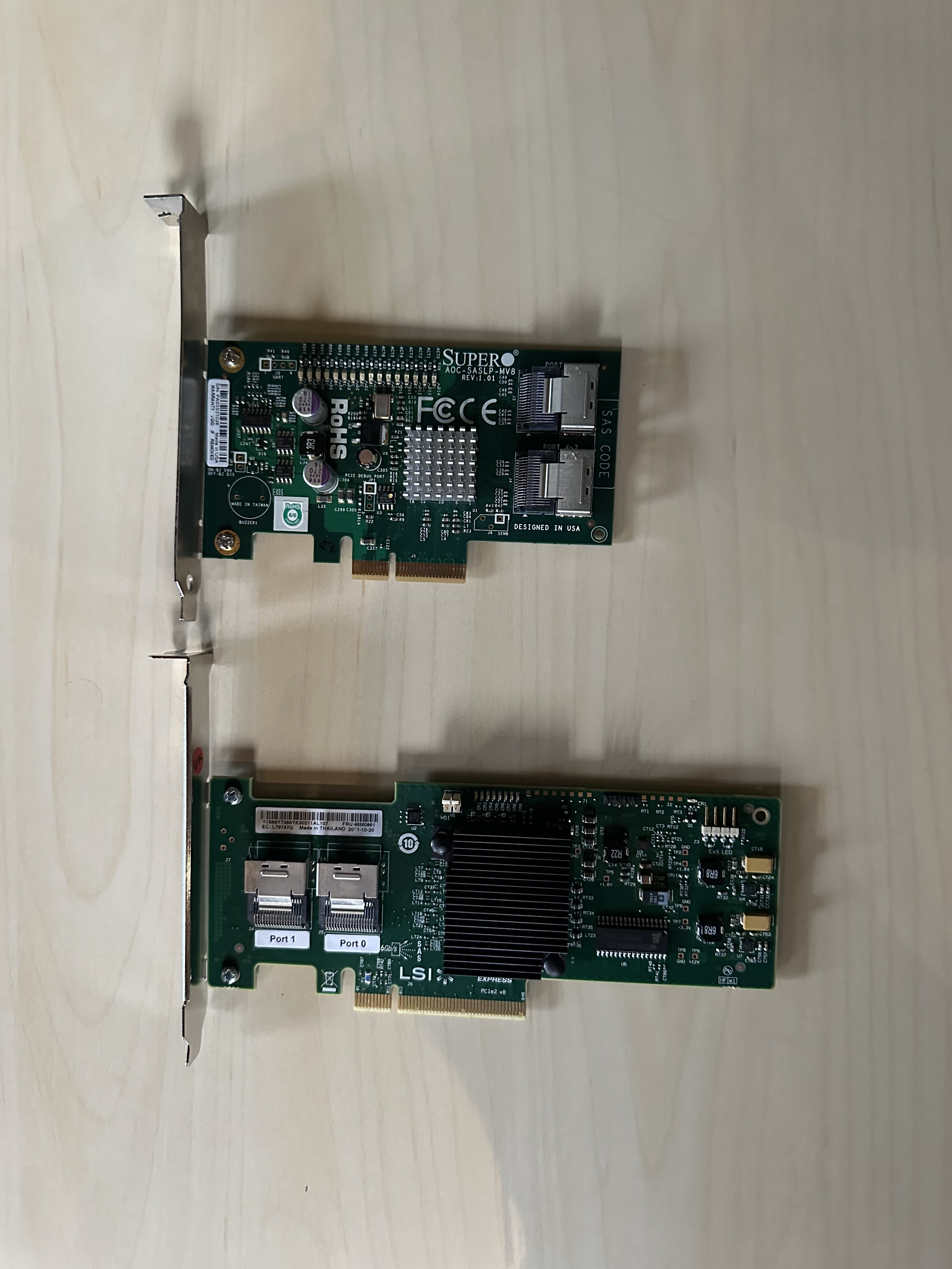

  2. Just a quick question… in this case does more pins = better performance? I have two controllers lying around, but I only need 1 of them.
