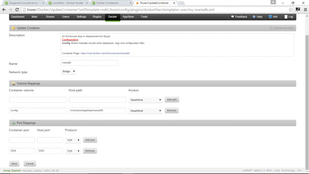

  1. yes, If thats set up wrong then please let me know the best way to set it up. Thanks in advance. Scott
  2. Attached as requested, I've no Idea if I've done it correctly

  5. Hostname: 192.168.1.105 = Ip address of unraid server port 3306 Username: root Password: (i've specified a password and typed it in) Connection method standard tcp/ip When trying to connect, it appears as if it cant find the server. In terms of system logs, where do I get them from?
  6. I'm hoping you can help as I'm about through the laptop out of the window. I've been trying for ages to set up the mariadb docker and eventually the kodi docker. I've both up and running however I cant connect to the the database at all. I've installed mysql workbench and tried connecting to the server but connection is always refused. I've found this whole process exceptionally frustrating and am hoping you guys can help please. Kind regards Scott
