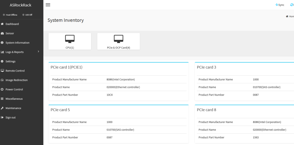

SAS drives gone after updating from 6.11.5 to 6.12.6 ...still gone after roll back
ok, new matching exact model HBA card fixed it!

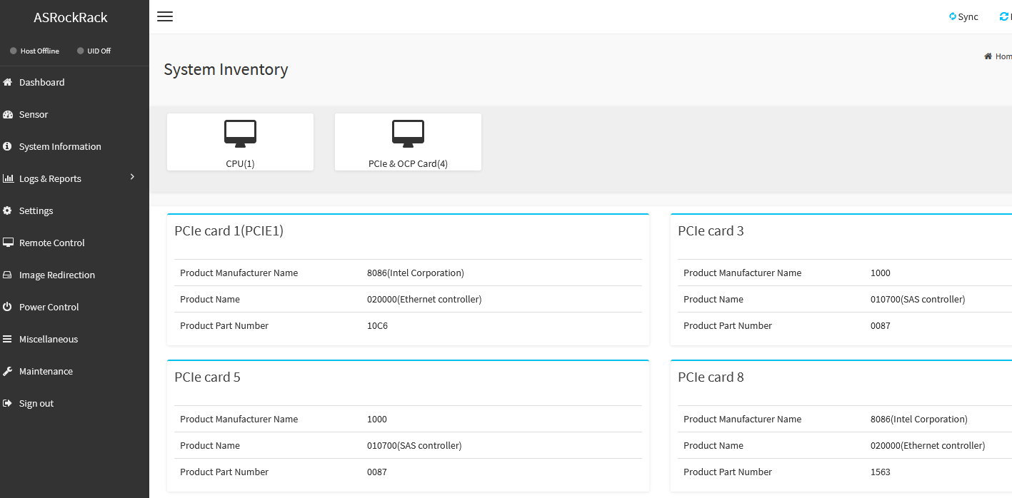

OKAY! Would you believe it? I was looking at this here IPMI screenshot and my bios boot screen and the actual servers it's self, one of the HBAs isn't showing up/
EDIT: ANY AND ALL CONTROLLERS ARE NON RAID AND ARE IT MODE! or atleast as far as i can tell, they are. rolling back did not help. for all i know i could loose a cable. i though hardware profiler might help but, their are what feels like thousands of lines of code. i'm just trying to see if maybe a driver for a controller card got dumped or killed i've attached a copy paste of profiler because there is no download a text file option. maybe if it hardware i get lucky and it's a loose cable but, its wierd because it was running for 13 months up time EDIT: normally i'd start shaking wires and all that but, it's 4f out and icey getting to it will be a challenge, i plan on updating this thread if i some how get lucky to figure something out. EDIT: Remembered i have IPMI, I doubt a shutdown will help but, i'm trying also i found this device listing [INSERT IMG] Please attached not insert image gui element found in forum posting ui. HP.txt
