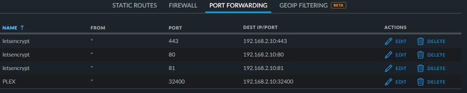

  4. I'm having an issue and I'm not really sure where to start. I'm not even 100% certain it's an issue with letsencrypt, which I run as a docker on UNRAID. Anyway, here is my situation. I recently moved, all infrastructure (unifi) moved with me, including my ATT gateway. Everything was shutdown at my home before I moved and I just booted everything back up (about 2 1/2 weeks later) at my new location. I have everything back up y and running again, all settings and configs are the same, including my WAN IP. All my dockers are up and running and fully functional except I for that I can no longer resolve any of my external applications that utilize letsencrypt with nginx reverse proxy. I can ping and resolve my domain name fine, and can even access PLEX externally, but nothing that was fronted by the letsencrypt docker seems to work, about 8 applications in all with the same generic error. No status code, nothing, just a "domain name" refused to connect message followed by a ERR_CONNECTION_REFUSED. Has anyone experienced any similar issues before where everything just stopped working? Thanks for any input.
  5. Originally, I only had 443 and 32400, but I've since added 80 & 81 to troubleshoot the issue. No luck. Here are the screenshots you requested. Thanks for taking a look.

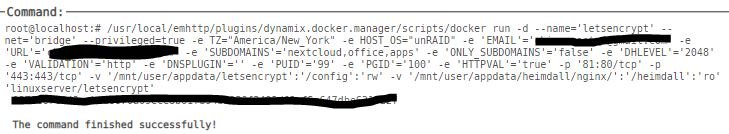

  6. Can anyone help with this? I updated letsencrypt today and now nothing is working. No other changes have been made. It's as if everything is trying to go over 8443 (which is what my UNRAID server is set to since there was a conflict between letsencrypt 443 and UNRAID 443. This is the error I'm getting: 2048 bit DH parameters presentSUBDOMAINS entered, processingSUBDOMAINS entered, processingSub-domains processed are: -d nextcloud.xxx.com -d office.xxx.com -d apps.xxx.comE-mail address entered: [email protected] validation is selectedGenerating new certificateSaving debug log to /var/log/letsencrypt/letsencrypt.logPlugins selected: Authenticator standalone, Installer NoneObtaining a new certificateSaving debug log to /var/log/letsencrypt/letsencrypt.logPlugins selected: Authenticator standalone, Installer NoneObtaining a new certificatePerforming the following challenges:http-01 challenge for apps.xxx.comhttp-01 challenge for xxx.comhttp-01 challenge for nextcloud.xxx.comhttp-01 challenge for office.xxx.comWaiting for verification...Cleaning up challengesFailed authorization procedure. apps.xxx.com (http-01): urn:ietf:params:acme:error:connection :: The server could not connect to the client to verify the domain :: Fetching https://xxx.unraid.net:8443/.well-known/acme-challenge/xxx: Invalid port in redirect target. Only ports 80 and 443 are supported, not 8443, office.xxx.com (http-01): urn:ietf:params:acme:error:connection :: The server could not connect to the client to verify the domain :: Fetching https://xxx.unraid.net:8443/.well-known/acme-challenge/xxx: Invalid port in redirect target. Only ports 80 and 443 are supported, not 8443, nextcloud.xxx.com (http-01): urn:ietf:params:acme:error:connection :: The server could not connect to the client to verify the domain :: Fetching https://xxx.unraid.net:8443/.well-known/acme-challenge/xxx: Invalid port in redirect target. Only ports 80 and 443 are supported, not 8443, xxx.com (http-01): urn:ietf:params:acme:error:connection :: The server could not connect to the client to verify the domain :: Fetching https://xxx.unraid.net:8443/.well-known/acme-challenge/xxx: Invalid port in redirect target. Only ports 80 and 443 are supported, not 8443IMPORTANT NOTES:- The following errors were reported by the server:Domain: apps.xxx.comType: connectionDetail: Fetchinghttps://xxx.unraid.net:8443/.well-known/acme-challenge/xxx:Invalid port in redirect target. Only ports 80 and 443 aresupported, not 8443Domain: office.xxx.comType: connectionDetail: Fetchinghttps://xxx.unraid.net:8443/.well-known/acme-challenge/xxx:Invalid port in redirect target. Only ports 80 and 443 aresupported, not 8443Domain: nextcloud.xxx.comType: connectionDetail: Fetchinghttps://xxx.unraid.net:8443/.well-known/acme-challenge/xxx:Invalid port in redirect target. Only ports 80 and 443 aresupported, not 8443Domain:xxx.comType: connectionDetail: Fetchinghttps://xxx.unraid.net:8443/.well-known/acme-challenge/xxx:Invalid port in redirect target. Only ports 80 and 443 aresupported, not 8443
