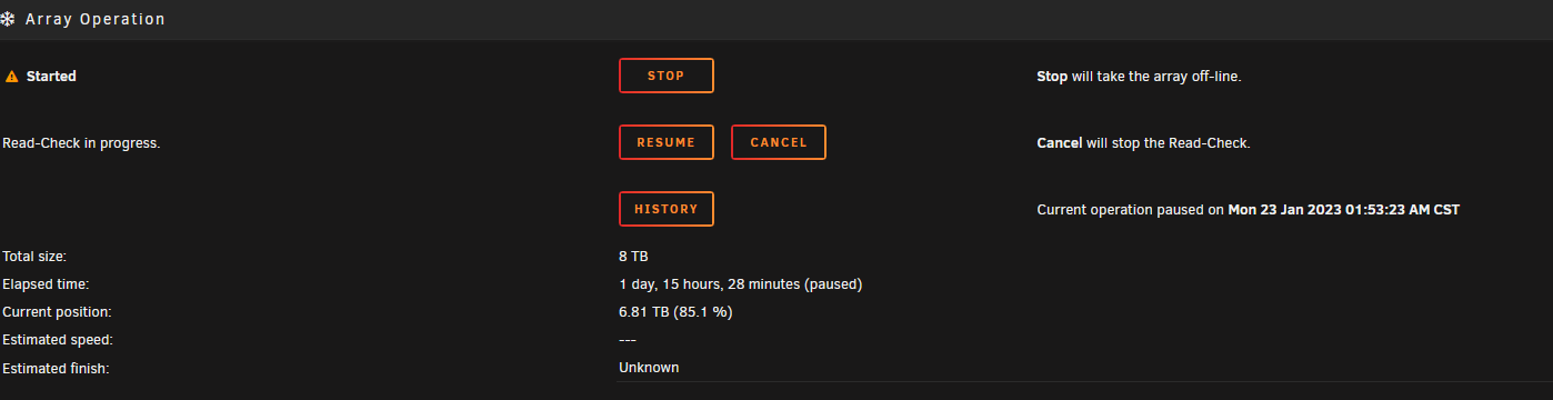

  6. So I pulled all my drives. Double checked all connections and restarted. Got the notification that array turned good. However, I do not see an option to resume my disk rebuild. Do I just hit this option to check? The disk just has an x next to it.
