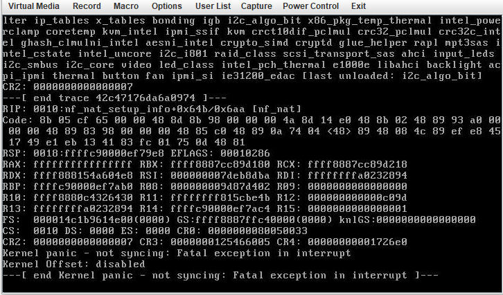

  8. Hi all, I need help since my server does not boot anymore after 6.11.5 -> 6.12.2 upgrade, it looks like it's crashing. I have reverted to 6.11.5 for now... Any help is appreciated. Best regards, IMG_0759 (1).mov
  9. Hi, since I have upgraded to 6.9.2 my unraid keeps crashing due to kernel panic every 3 or 4 days. My syslog is attached, I really appreciate any help. Best regards, André Rung syslog-192.168.0.175.log
