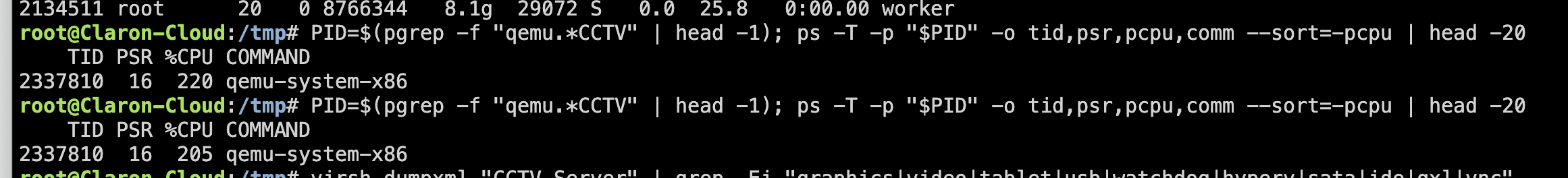

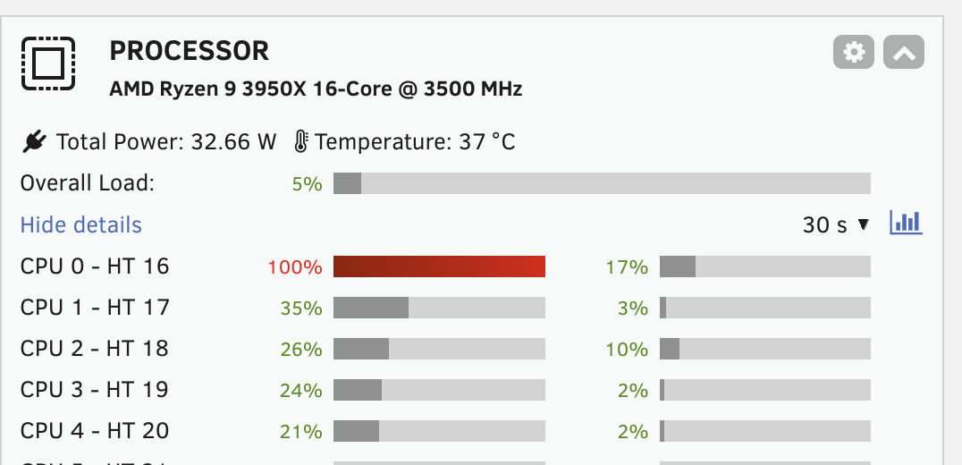

  1. I've just created a new VM and installed the same OS. It does not appear to be causing the CPU core to pin at 100%
