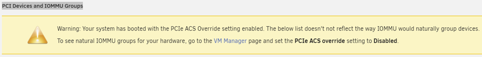

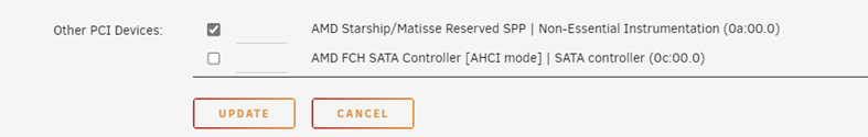

Thanks for replying and providing the guidance, JorgeB! I checked the settings for each VM and found that one did have a box checked next to that controller (03 - Windows 10 - 02102021-> 01302023 - Windows 10 Steam Oculus). I removed the check (see screenshot below) and updated the settings. I also looked at "Tools – System Devices" and noted that there was no check in the box by the IOMMU grouping for that controller (see screenshots below). Three of the four drives with read errors are associated with that controller, as I am sure you are aware given the instruction you provided! What should I do next? As noted, I have not rebooted the machine or anything since this issue occurred. If it helps, there is only one VM that I am really running/using at present, and it wasn't the one referenced above. My primary concern right now is just making sure those 3 drives work again and that I haven't lost any files. In short, we can talk about the problems with those remaining VMs another day, I am sure you are swamped with the release of Unraid 7! Dave ...
