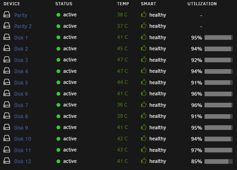

  3. You did say "Dashboard", didn't you Looks good:

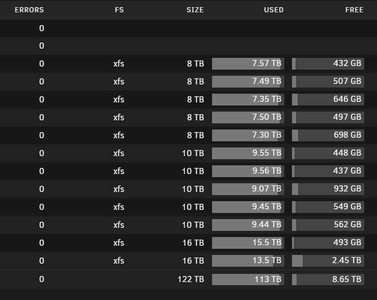

  4. Oh. Is that something I need to look at changing/correcting? Anything I need to worry about going through this process? disk1 is one of the 8TBs that's going away.
  5. Is the "Errors" column where I'd see SMART errors? Looks clean.
