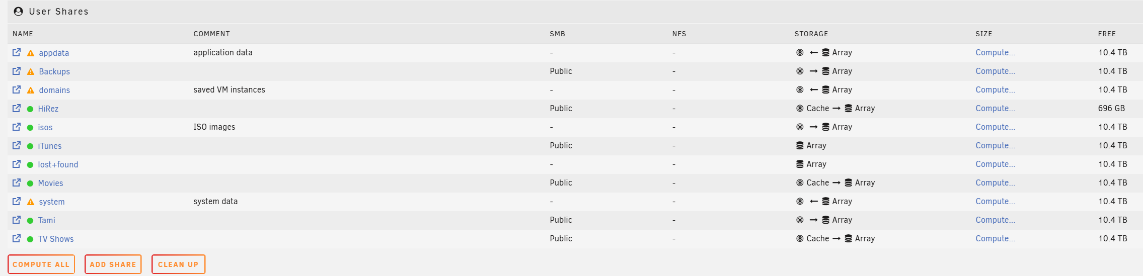

Thank you, Jorge - that was the setting that changed! Mover appears to be working correctly now - many thanks!

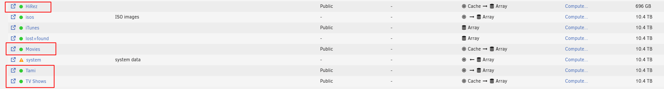

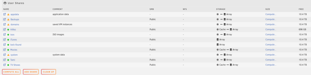

Thanks, Jorge - my cache is at 90% utilization right now - so the highlighted shares would/could have data waiting to be moved tower-diagnostics-20250305-0818.zip

Been reading through the threads that match up with my issue - so believe my cache settings have changed, but unsure of next steps. (It was a LONG time ago when I set up my cache drive and it was so simple, I have no idea how to backtrack) Thanks in advance for any help - tower-syslog-20250305-1552.zip

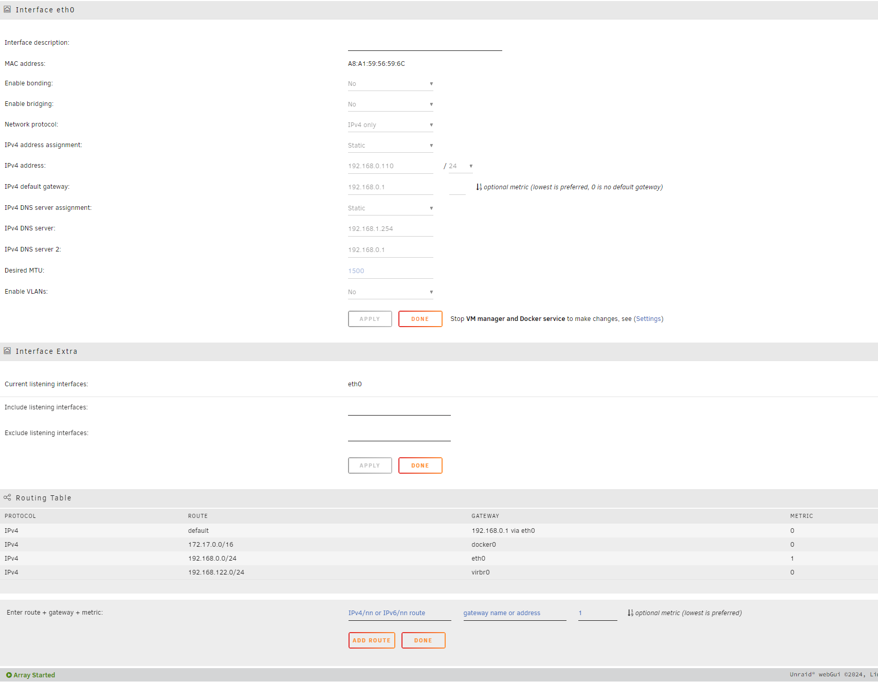

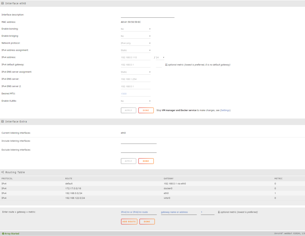

Just in case someone sees something in my network settings that looks off or needs to be adjusted...
