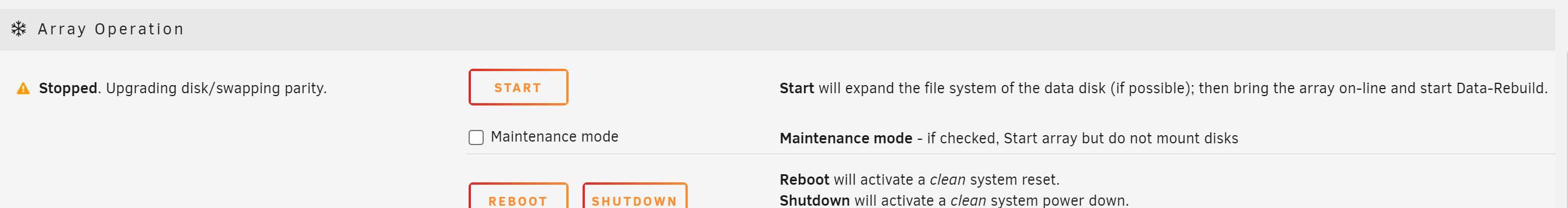

drive replacing with larger drive that the parity drive
Ok I found my answer , I needed to press start
I have another questiion Is the parity drive still rebuilding? I see the following message Stopped. Upgrading disk/swapping parity.
I understand now , for some reason I thought It would be more complicated . I started the copy , I have a little chile to go. 6 TB to copy .. Thank you for all your Help @itimpiand @Gragorg I will let you know how everything goes , once completed
