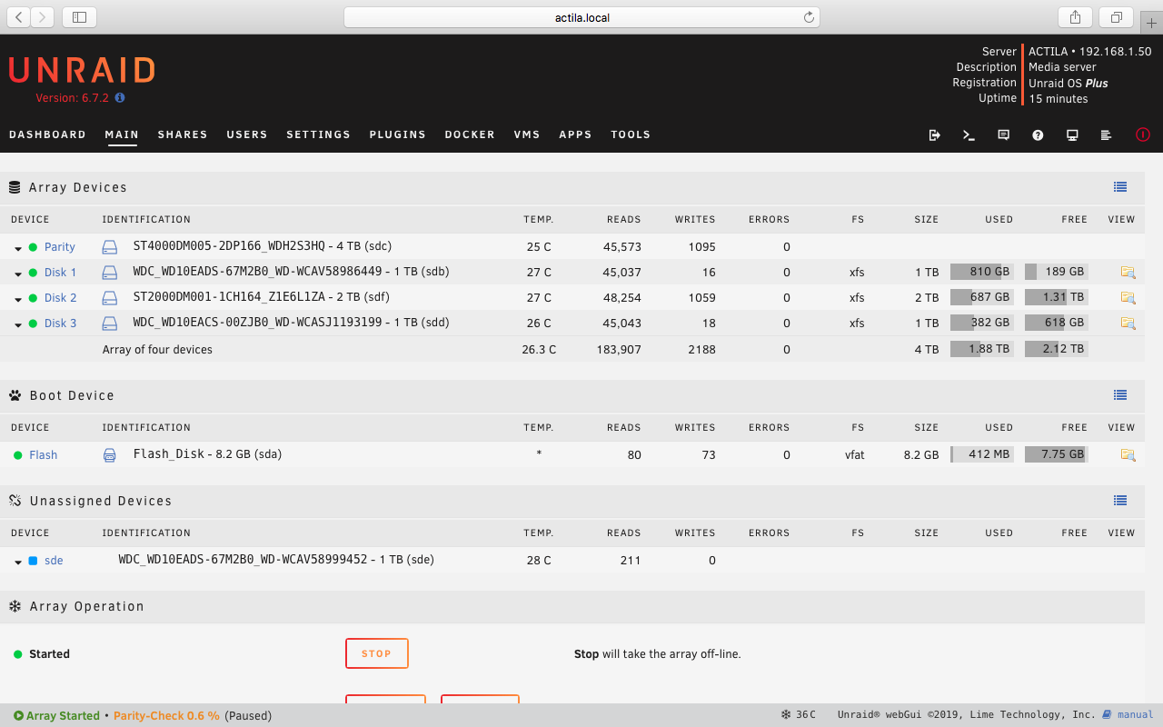

  1. I might have forgotten how many disk drives I actually had. When I started Unraid OS, it went in to normal state, and working as it should. I think... I connected the 6 data drives I thought I had. 1 seems to be broken and won´t start. I changed both SATA-cable and power cable and changed SATA-port. It will not work. 1 shows as unassigned. Should I consider everything as ok and use it as normal now? Screenshot and diagnostics attached. vars.txt actila-diagnostics-20210817-1944.zip
