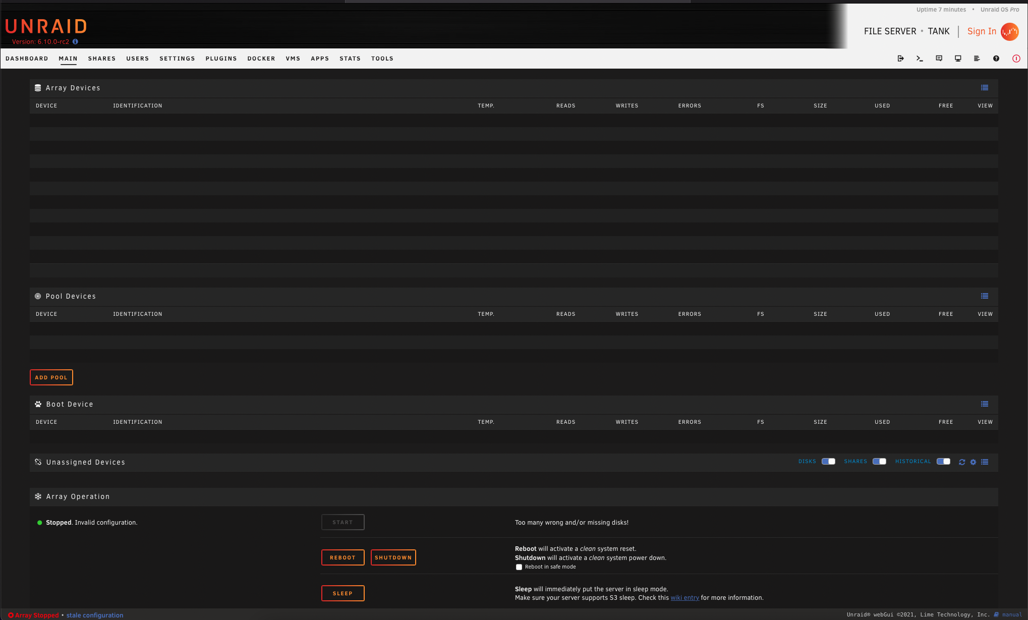

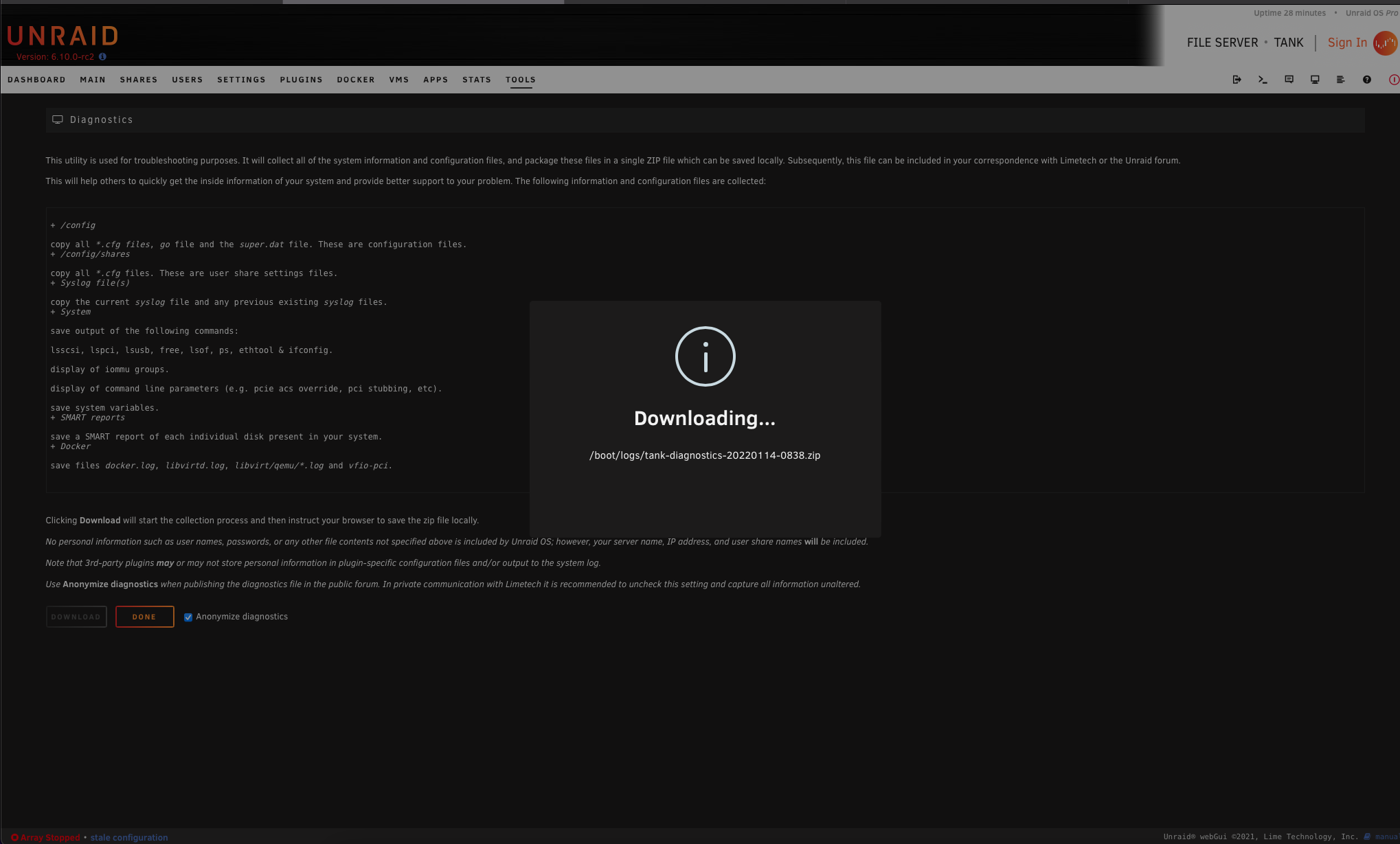

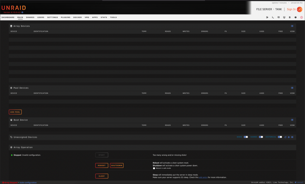

I have a serious issue (to me) that just popped up. I was having issues with my server so I got a new case with a new backplane and power distribution. Yesterday I rebuilt it and it seemed to be working fine. Parity repaired the one bad drive. I managed to copy a bunch of my photos off to my desktop array. This morning the server was still running. I went to update one of my dockers and it said it was not connected to the internet. I rebooted the server and when it came back up there were NO drives listed. Another thing is that it says that its connect to unraid and then it disconnects regularly. I also cannot download a diagnostic report. Every time I run it it just stalls and never downloads. Steps I have done: - Replaced the SAS controller with a different model - Rebooted with no cards in it other than SAS controller. No matter what I do I cannot find the drive.

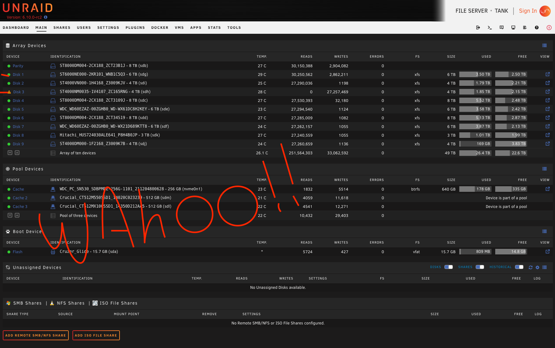

I restarted the array and.... WAHOO!! Its working! Happily repairing Disk 3 (which by the way was never a problem all along but somehow got corrupted with all of the power faults). Thank YOU ALL especially @trurl for sticking with helping me out. I have to say I spent a few nights feeling sick to my stomach. I purchased a dropbox business account with unlimited data and will be backing up to that + my 27TB desktop array along with getting another parity drive.

Here are my diagnostics. tank-diagnostics-20220113-1235.zip
