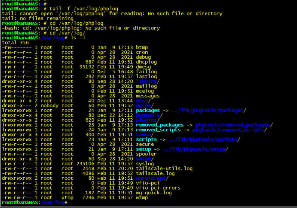

  7. While having Firefox open to the IP of the server on another monitor this is what I get. I have refreshed the page multiple times but still nothing in the phplog, not even a phplog generated it seems.
  8. Tried this twice just now: I deleted the SERVER_unraid_bundle.pem from the flash drive and then manually stopped nginx and then started nginx via CLI, this generated another SERVER_unraid_bundle.pe but still the same 500 Internal Server Error. I deleted the SERVER_unraid_bundle.pem from the flash drive and then rebooted back into safemode. After booting into safemode, going to the IP in the browser gave a page cannot be displayed error. Logging back into CLI and received the following: root@banaNAS:~# /etc/rc.d/rc.nginx status Nginx server daemon is not running. I then tried to manually start nginx but again got the 500 Internal Server Error.

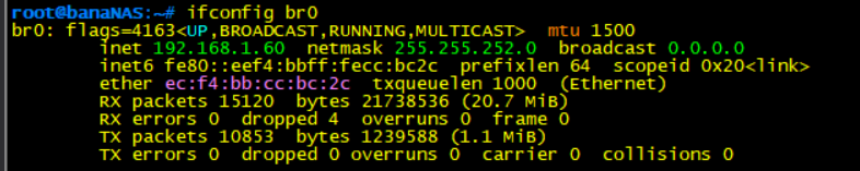

  10. It does get an IP, I am able to SSH into the server remotely. (I also have IPMI access to help troubleshoot as theres no monitor)
  11. I am not able to access the webui via the IP in a browser, but if i launch Safe mode with GUI I do get a linux desktop. That opened a Firefox page automatically to https://localhost/ and it gets an "Unable to Connect" page.
