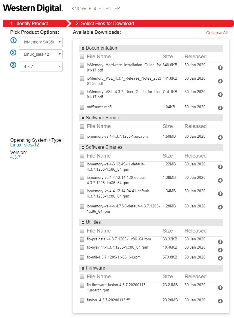

  3. As a technical note, FusionIO/WesternDigital are still supporting their products with drivers current as of 01/30/2020. Energen....these are still great cards, and hella not obsolete for this application. I have a ioDrive2 and a SX350 that can do ~2GB/s+ R/W at 8W idle through a ESXi6.7 VM with super low latency like nvme. If i were to make a guess, I'd say there are prolly ~50-60 of us in the forums that would integrate FusionIO prducts into our builds and at least that many more that would be inclined to buy these cheap used cards in the future for that purpose. No, we aren't a majority... but it's not 5 or 6 or a dozen. There's dozens of us... Tom, the CEO and admin, chimed in on this thread and put the ball in our court. If we want to merge this into his repo, somebody will need to work on the 5.X kernel integration. I would suggest following this proxmox guide as a starting point. -> https://forum.proxmox.com/threads/configuring-fusion-io-sandisk-iodrive-iodrive2-ioscale-and-ioscale2-cards-with-proxmox.54832/
  4. I don't believe licensing is the issue, these are "EOL/past their 5yr support agreement" according to FusionIO ... so they are not guaranteeing continued updates that would work with newer kernels in the future. Since they are completely reliant on software to work, this kind of tombstones the devices for current kernels when support stops. That being said as of right now, new drivers are being released every couple months... with the latest released Jan 30 2020 (see attached). Regardless, I'm trying to figure out a way to incentivize Dave @ servethehome forums (former fusionio software dev) to pitch in. Any and all ideas are welcome. It doesn't look like merging these drivers into the mainline is possible now. Is it possible to move forward with the source supplied by WD?
  5. True, I appreciate any time you can devote to this matter. As you are probably aware, these devices are high IOPS/high STR/low latency flash pcie cards with extremely long endurance ratings that can be had for <$0.08/GB now. They are ideal for cache and VM, especially at this price point however are 100% driver/VSL dependant. I am in contact with a guy that worked on development and support of these cards for FusionIO/Sandisk/WD. Dunno if it helps, but this was his reply when asked the same thing regarding driver inclusion about the gen2/ioDriveII product: "So unraid is slackware, and as such is using a 4.x kernel right now. You'd have to go into the driver download section for fedora/etc that feature a 4.x kernel and grab the iomemory-vsl-3.2.15.1699-1.0.src.rpm that is available there. I'd probably stand up a development slack VM with the kernel headers/build env setup and use that to build your kernel module for the ioDrives. As someone has already stated, if you update unraid, that ioDrive kernel module won't load and you'll have to build a new one for your newer kernel before the drives will come back online. You can set stuff up with dkms to auto-rebuild on new kernel updates, but that can sometimes be a bit of a learning curve... -- Dave" Previously, I just dumped a directory of all support files for SLES11/12 .... is there anything I can do or ask Dave to make driver integration easier?
  6. Fusion IO (Sandisk, now owned by WD) supports RHEL; SLES; OEL; CentOS; Debian; Ubuntu https://link.westerndigital.com/enterprisesupport/software-download.html SUSE 11/12 current drivers and utilities: SX300/SX350/PX600 Linux_sles-12 driver v4.3.6 20191116 (current) - SRC -> iomemory-vsl4-4.3.6.1173-1.src.rpm - BIN -> iomemory-vsl4-3.12.49-11-default-4.3.6.1173-1.x86_64.rpm -> iomemory-vsl4-4.4.21-69-default-4.3.6.1173-1.x86_64.rpm -> iomemory-vsl4-4.4.73-5-default-4.3.6.1173-1.x86_64.rpm - Utility -> fio-preinstall-4.3.6.1173-1.x86_64.rpm -> fio-sysvinit-4.3.6.1173-1.x86_64.rpm -> fio-util-4.3.6.1173-1.x86_64.rpm SX300/SX350/PX600 Linux_sles-11 driver v4.3.6 20191116 (current) - SRC -> iomemory-vsl4-4.3.6.1173-1.src.rpm - BIN -> iomemory-vsl4-3.0.101-63-default-4.3.6.1173-1.x86_64.rpm -> iomemory-vsl4-3.0.101-63-xen-4.3.6.1173-1.x86_64.rpm -> iomemory-vsl4-3.0.76-0.11-default-4.3.6.1173-1.x86_64.rpm -> iomemory-vsl4-3.0.76-0.11-xen-4.3.6.1173-1.x86_64.rpm - Utility -> fio-preinstall-4.3.6.1173-1.x86_64.rpm -> fio-sysvinit-4.3.6.1173-1.x86_64.rpm -> fio-util-4.3.6.1173-1.x86_64.rpm ioDrive/ioDrive2/ioDrive2Duo/ioScale Linux_sles-12 driver v3.2.16 20180912 (current) - SRC -> iomemory-vsl-3.2.16.1731-1.0.src.rpm - BIN -> iomemory-vsl-4.4.21-69-default-3.2.16.1731-1.0.x86_64.rpm -> iomemory-vsl-4.4.73-5-default-3.2.16.1731-1.0.x86_64.rpm - Utility -> fio-common-3.2.16.1731-1.0.x86_64.rpm -> fio-preinstall-3.2.16.1731-1.0.x86_64.rpm -> fio-sysvinit-3.2.16.1731-1.0.x86_64.rpm -> fio-util-3.2.16.1731-1.0.x86_64.rpm ioDrive/ioDrive2/ioDrive2Duo/ioScale Linux_sles-11 driver v3.2.16 20180912 (current) - SRC -> iomemory-vsl-3.2.16.1731-1.0.src.rpm - BIN -> iomemory-vsl-3.0.101-63-default-3.2.16.1731-1.0.x86_64.rpm -> iomemory-vsl-3.0.101-63-xen-3.2.16.1731-1.0.x86_64.rpm -> iomemory-vsl-3.0.76-0.11-default-3.2.16.1731-1.0.x86_64.rpm -> iomemory-vsl-3.0.76-0.11-xen-3.2.16.1731-1.0.x86_64.rpm - Utility -> fio-common-3.2.16.1731-1.0.noarch.rpm -> fio-preinstall-3.2.16.1731-1.0.noarch.rpm -> fio-sysvinit-3.2.16.1731-1.0.noarch.rpm -> fio-util-3.2.16.1731-1.0.noarch.rpm -> lib32vsl-3.2.16.1731-1.i686.rpm
