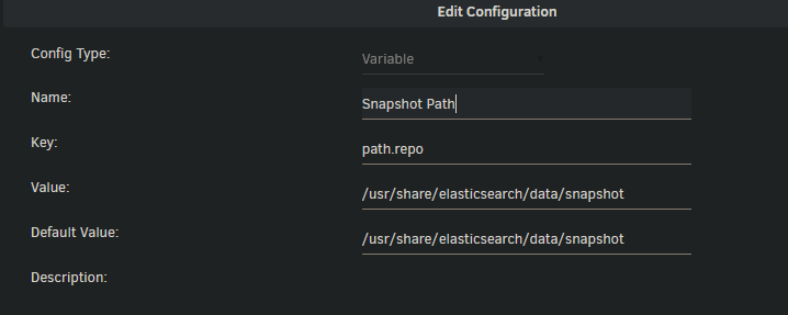

  3. I fixed it. The path is the same as yours and I have enough space, but I just didn't notice that the /usr/share/elasticsearch/data path is inside the cointainer... haha (in my defense, I never saw a variable for a path inside the container before). Anyways, it couldn't create the files and folders because it lacked permissions. I used the same command "chown..." as earlier and now it successfully created all the things and it works now! Thanks!

  5. I can't get ES to start. It can't find (access?) the path.repo. I didn't change it from the default as it said in the installation guide. It says to check the log at /usr/share/elasticsearch/logs/docker-cluster.log, but the file (and folders) are not there. I tried creating the elasticsearch folder and setting the permissions (chown 1000:0 -R) manually, but still the same error. I'm on unRAID Version: 6.10.3 and installed TubeArchivist for the first time. Docker log: @timestamp=2022-12-03T07:10:09.032Zecs.version=1.2.0elasticsearch.cluster.name=docker-clusterelasticsearch.node.name=3092b8c09c8aerror.message=Unable to access 'path.repo' (/usr/share/elasticsearch/data/snapshot)error.stack_trace=java.lang.IllegalStateException: Unable to access 'path.repo' (/usr/share/elasticsearch/data/snapshot) at [email protected]/org.elasticsearch.bootstrap.FilePermissionUtils.addDirectoryPath(FilePermissionUtils.java:66) at [email protected]/org.elasticsearch.bootstrap.Security.addFilePermissions(Security.java:252) at [email protected]/org.elasticsearch.bootstrap.Security.createPermissions(Security.java:178) at [email protected]/org.elasticsearch.bootstrap.Security.configure(Security.java:125) at [email protected]/org.elasticsearch.bootstrap.Elasticsearch.initPhase2(Elasticsearch.java:186) at [email protected]/org.elasticsearch.bootstrap.Elasticsearch.main(Elasticsearch.java:66) Caused by: java.nio.file.AccessDeniedException: /usr/share/elasticsearch/data/snapshot at java.base/sun.nio.fs.UnixException.translateToIOException(UnixException.java:90) at java.base/sun.nio.fs.UnixException.rethrowAsIOException(UnixException.java:106) at java.base/sun.nio.fs.UnixException.rethrowAsIOException(UnixException.java:111) at java.base/sun.nio.fs.UnixFileSystemProvider.createDirectory(UnixFileSystemProvider.java:397) at java.base/java.nio.file.Files.createDirectory(Files.java:700) at java.base/java.nio.file.Files.createAndCheckIsDirectory(Files.java:807) at java.base/java.nio.file.Files.createDirectories(Files.java:793) at [email protected]/org.elasticsearch.bootstrap.Security.ensureDirectoryExists(Security.java:330) at [email protected]/org.elasticsearch.bootstrap.FilePermissionUtils.addDirectoryPath(FilePermissionUtils.java:64) ... 5 more error.type=java.lang.IllegalStateExceptionevent.dataset=elasticsearch.serverlog.level=ERRORlog.logger=org.elasticsearch.bootstrap.Elasticsearchmessage=fatal exception while booting Elasticsearchprocess.thread.name=mainservice.name=ES_ECS 03/12/2022 16:10:09 ERROR: Elasticsearch did not exit normally - check the logs at /usr/share/elasticsearch/logs/docker-cluster.log 03/12/2022 16:10:09 ERROR: Elasticsearch exited unexpectedly
