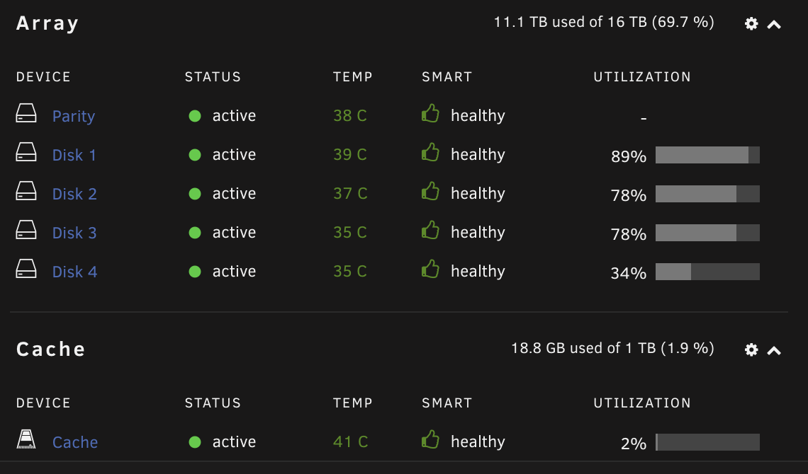

  1. Copy that, I will get a new drive and replace the disk. Seems like a good time to run tests on the other drives too.. Question - Is it normal for my dashboard to show all disks as healthy even if the extended smart test fails? If so what is the dashboard really showing is "healthy"? Attaching screenshot of the dashboard area I'm referring to. Thank you

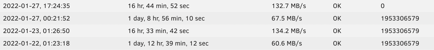

  5. Beautiful, Second parity check completed with 0 errors. Attaching final diagnostics just for future reference. @Frank1940 & @JorgeB Thank you both so much for your guidance and time. Truly appreciated! Have a good one guys and keep up the great work. phoenix-diagnostics-20220127-1725.zip
  6. Update on second set of checks so far: 1st check (correcting) found & corrected the same amount of errors as before. 2nd check (non correcting) is about halfway through right now and has found 0 errors so far. It's looking like the IDE setting on my last 2 SATA ports was the culprit. Will post final diagnostics after 2nd check is complete just for reference.
