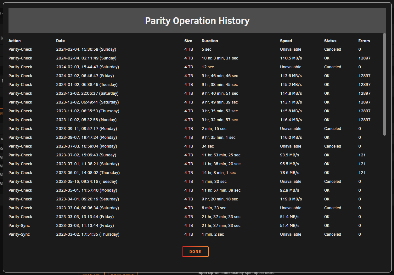

  8. Yes, the errors are consistently the same. Currently I'm dealing with 12897. A few months prior I was dealing with Parity having 121 errors, but that eventually seems to have fixed itself before this incident. Here's a screenshot of my Parity Check history. The cancellations are usually me realizing I hit Check again instead of the History button. I'm glad this is the case, and I assumed as much. However at this point I wonder what's gone wrong with the Parity. Seeing this made me get a little antsy!
