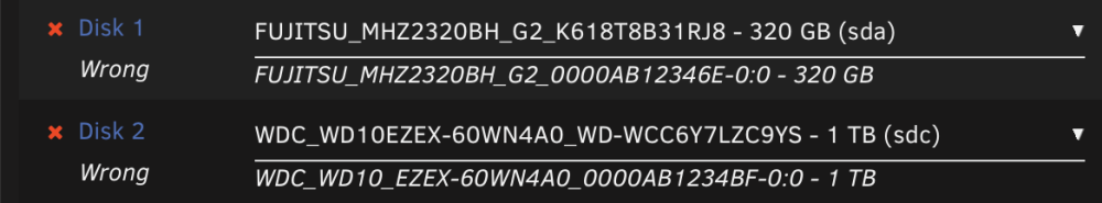

  1. Yes this did the trick. Thank you so much!
  2. I don't have parity disks. I do not use my system for backups so I couldn't justify the cost. Can I manually change the id?
  3. I just restored my system to the old version. The disks work now. But I do want to update my system.
  4. Hello, I had some issues with my vm's crashing so to troubleshoot I decided to update my machine. After I had updated I couldn't start the array. I had 2 missing disks. (see attachment) However the disks could be read. They are plugged in via an usb adapter and were working before. Also attached is a zip file with the diagnostics. Thanks! corrie-diagnostics-20230207-1719.zip
