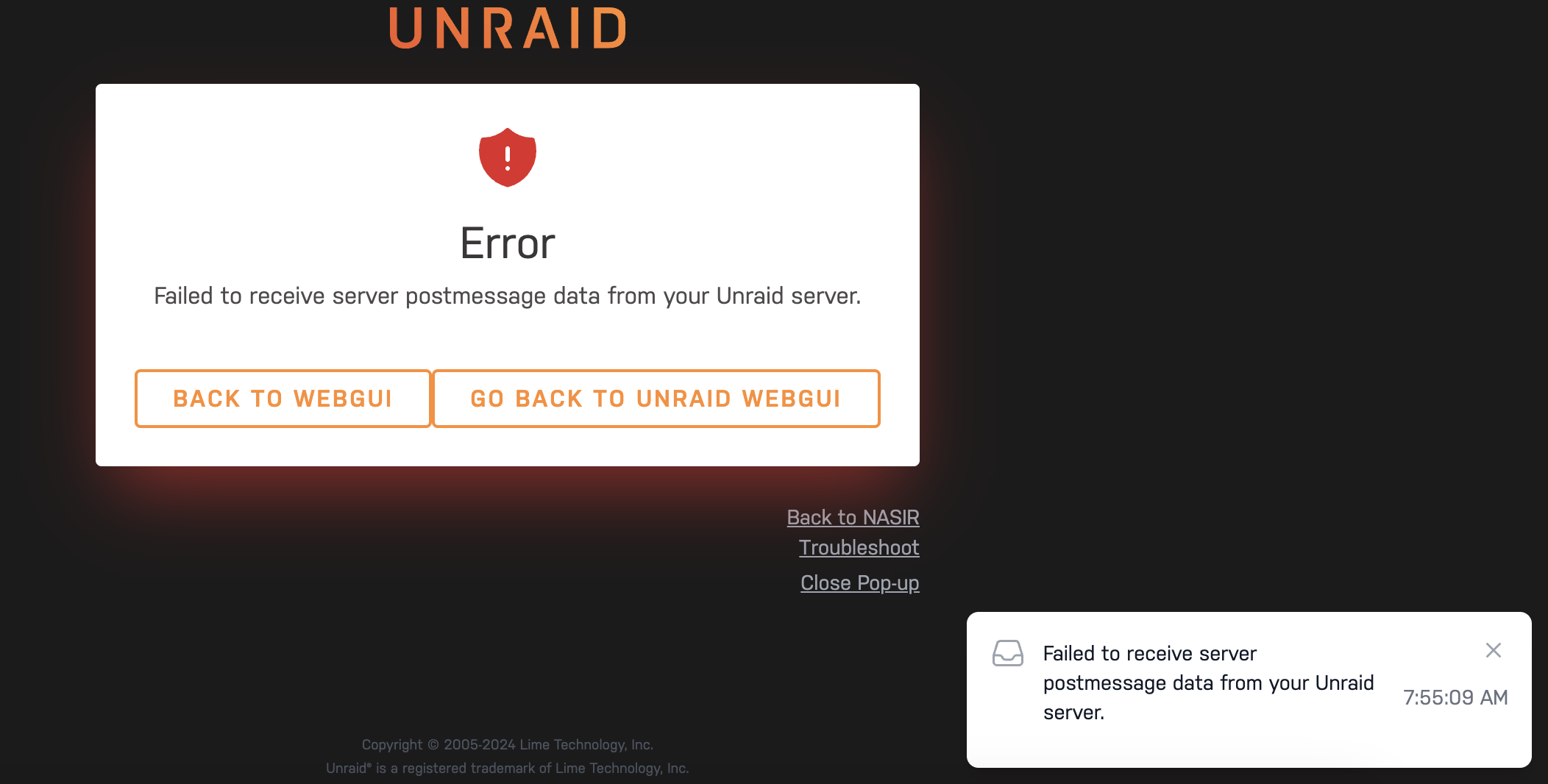

  11. Only thing I can get to work is by doing the OS Update check when the webpage is https://MyServerIP.SuperLongHash.myunraid.net/Dashboard and maybe 75% of the time it won't kick to the error message. Still not trying the update yet - I'm on 6.12.3
  12. Nope, seems to be back to giving me the error message
  13. It seems to work if I do it from https://MyServerIP.SuperLongHash.myunraid.net/Dashboard vs the tab via https://connect.myunraid.net/server/
  14. Looking to see if any one knows what is happening here. Getting this message "Failed to receive server postmessage data from your Unraid server." when I tried to take a look at the new OS update feature and when it punches out to the review page I can see the OS versions available and then about 5 seconds later it kicks to this message/screen. If I go to Update OS in the Tools menu it just hangs and nothing shows up. I just updated the Unraid Connect plugin right before trying this. Diagnostics attached if needed. nasir-diagnostics-20240110-0800.zip
  15. That did it, thank you sir.
