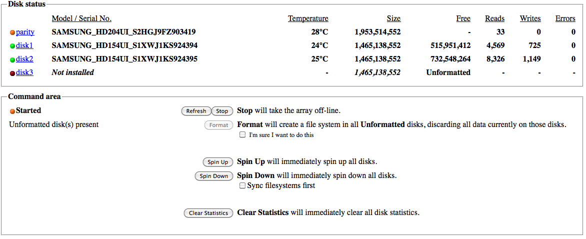

I'm also concerned because when I bring up my disk array without disk3 configured, just running off parity, it tells me that disk3 is actually unformatted.  Why would this be?
I think I'm slowly losing my data, and I'm pulling my hair out trying to figure out why, as no disk as failed so unRAID shouldn't have gotten into this state to begin with.

Attached.  I've rebooted a couple times since the initial incident due to troubleshooting steps.  The system is currently running "reiserfsck --scan-whole-partition --rebuild-tree /dev/md1"
/dev/md3 is my trouble disk though, and with disk1, disk2, and parity up, I can't see anything that would've been on disk3.  When I try to check or mount disk3, I just get the "Cannot read the block (2): (Input/output error)" message.

Disk 3 (number 687, 1.5TB) started showing as unformatted.  I went and replaced it with a 2TB disk, and after stopping and starting the array several times, unRAID finally gave me the option to move the parity to the larger disk, which it said it completed.  When it finished, disk 3 (now the old parity disk) still showed up as unformatted, and my parity disk showed up as orange.  Since then, I've been trying to get the array to rebuild disk 3 unsuccessfully.  It seems like /dev/md3 in the array became unformatted somehow, and that the array doesn't think there is a proper disk 3 to rebuild anymore.  I'm so frustrated with this as I've already spent 2 days straight trying to correct it.
I didn't run the initconfig command, nor did I hit the restore button if/when it ever came up.
By re-starting the array as you did, you might have lost the ability to recover from parity. It looks like disk3 died while you were trying to re-construct parity.  At that point you had two bad drives...

Apologies for the poor description earlier.  I've had very little sleep in the past couple days, and mixed in with work, I'm just trying to bring my NAS back up.
This is essentially what I did, and it copied the parity to the 2TB drive, however putting the 1.5TB (old parity) drive in the spot of disk 3 doesn't work.  After I start the array and check the box to rebuild it, it says it's unformatted.  When I try to format it, it shows the error you see in the syslog.

You have posted that you aquired another 1.5T drive so this is what you can try. There are no guarantees this will work but it might get back most of your data. Follow these steps;
Upgrade to unRAID 4.7.
Put the original parity back in place and leave the disk3 slot empty.
Assign the new drive to the cache slot and start the array and format the disk. Do not let a parity check run here. if it doesn't want to start then skip this step.
Stop the array and assign the new drive to the disk3 slot.
Log-in and run initconfig, answer Yes.
Use the trust my parity procedure except use 3 instead of 99 for the invalid slot - "mdcmd set invalidslot 3". You should get a response "cmdOper=set" and "cmdResult=ok".
Refresh the web interface. It should show the array is ready to start so press start.
Refresh the main unRAID page. You should see disk3 having writes and all others with reads.
Run reiserfsck on the disk3 and see if it can fix it up and what data you get back.
http://lime-technology.com/wiki/index.php?title=Check_Disk_Filesystems
