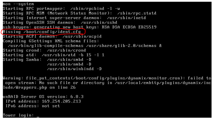

The issue is that i CAN boot Unraid...sortof... i get the classic blue dialog during boot and it boots up. But it seems like something is wrong, all configuration is missing. In fact the /boot/config is missing almost everything. I'm having a hard time getting a diagnostic file of the system since i have no network and i'm a bit unsure how else to do it with "half an OS"...
After reading through a couple of posts in here and a little of googling i tried pulling the usb-device and repairing and running the .bat file for making it bootable again. It didn't change anything. It did say something needed repair. But it didn't change anything during the boot 😕 When i look at the USB stick in windows i can see all the configuration files and stuff that it is complaining about during boot, e.g. "/boot/config/ident.cfg"...

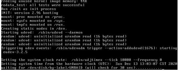

...well, i think i found the original culprit. There was defently something wrong with the thumbdrive. Kept getting corrupted and then the image-tool started giving all sorts of errors when i tried flashing a clean new Unraid install. 6month old Samsung drive 😞 So it went flying and i am now using another thumb which flashes just fine...
...but.... i still get the errors on this fresh install. I'm losing my mind over this. This ran just fine before i did the stupid BIOS-flashing... what BIOS-setting can possible cause Unraid to behave like this?
It's also waiting a long time for this:
...i'm guessing this is the cause for why there is not config from the thumb... just haven't got a clue on why i can boot from the drive but Unraid can't find it...seems counterintuitive to me to be honest...
