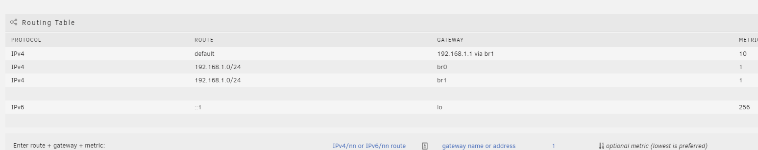

This problem is still here to some degree.  I followed the recommendations of Vr2lo above.  With the 10g NIC swapped out as eth0 and the 1G NIC as eth1.  eth1 disconnected and "disabled", I have no access to the internet from the UNRAID or any VM/Container.  (Pings and Traceroutes to LAN devices come back fine, Pings and Traceroutes on the Public Internet timeout) I can connect to it via the LAN and see all the shares, however it cannot get to the internet.  As soon as I plug back in the 1g NIC and enable it, all of the internet connectivity is restored, however when I navigate to "//UNRIAD" it is using the 1g NIC again (not the 10g).  I feel like there are some settings that UNRAID is not "letting go" of the 1g NIC.

On 1/14/2021 at 10:46 PM, Vr2Io said:
But I haven't any problem ( include Internet ), I swap Unraid to a new motherboard yesterday also same.
If local haven't problem, then suppose problem in network rather then Unraid.
Pls capture Network setting screen for ref.

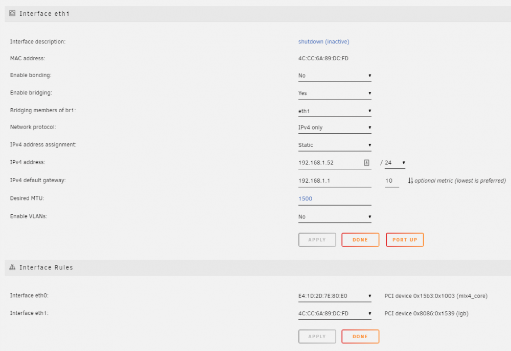

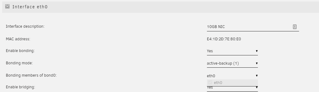

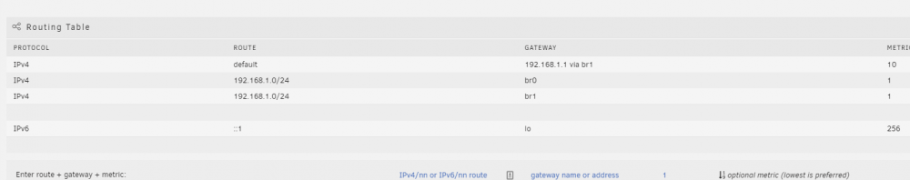

image.thumb.png.040259a067b045ccde5bafdc7377bee3.pngimage.thumb.png.6fda2f2608e3eff6e0ddbbcc55a966f6.pngimage.thumb.png.5e486cc4098285f3e19b28f1a6adbe9c.png
Then you have two bridge br0 (eth0) and br1 (eth1), for example, if unplug eth1 then all container/docker under this bridge will lost Internet.

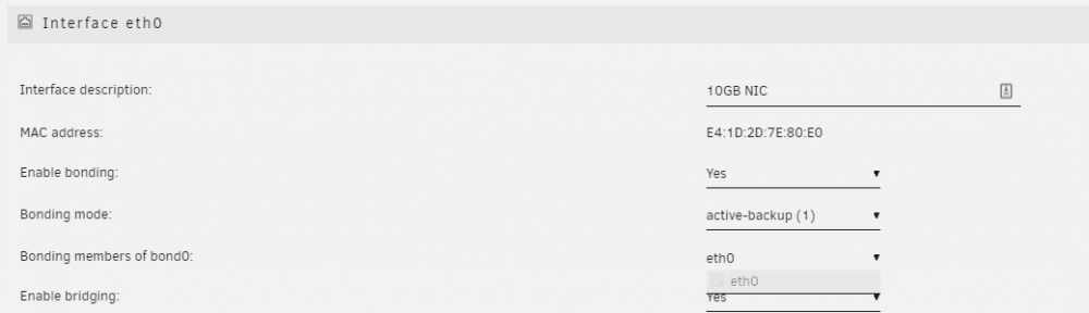

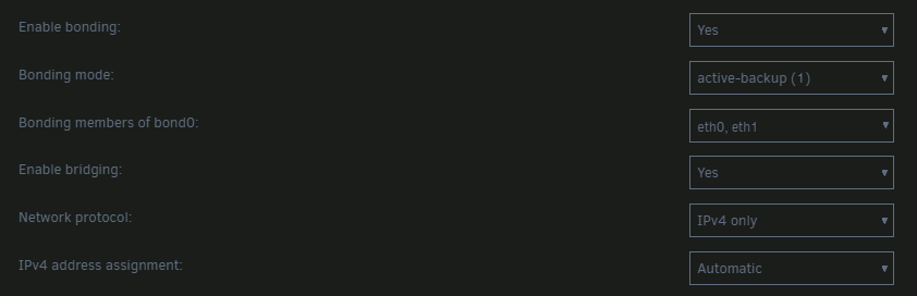

When I turn on bonding, I only have the option to select the interface it is currently on.   For example Eth0 only has a eth0 in the bonding drop down.  Shouldn't I select the other NIC in this box?  This is with bonding "on" both interfaces.
Edited by TheWoodser

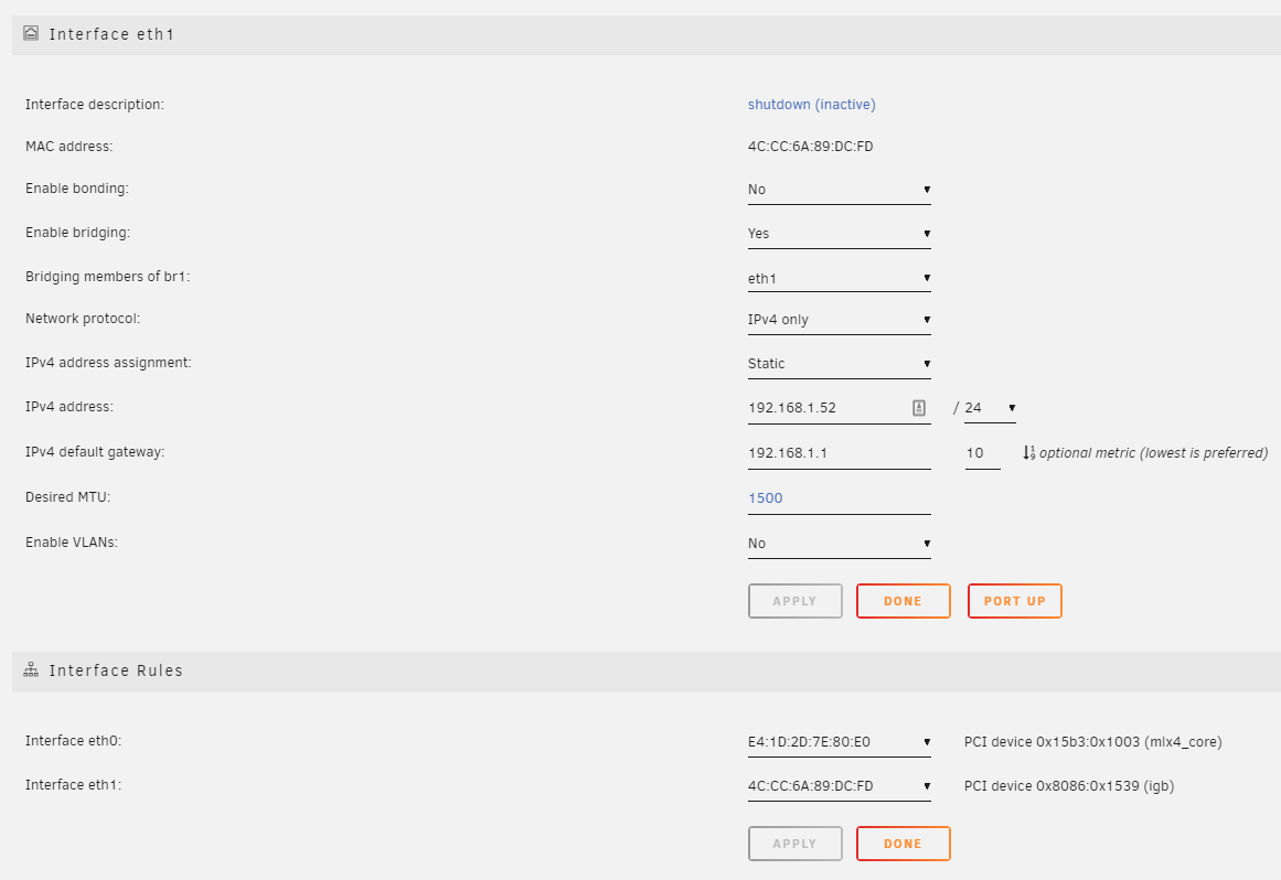

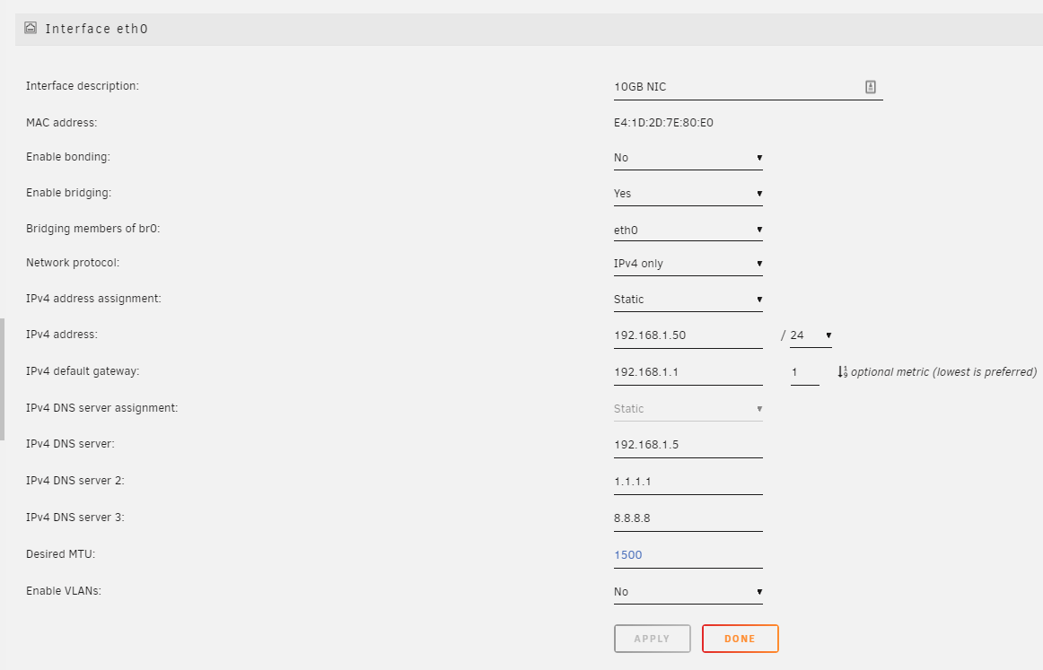

Pls disable Eth1 bridge, may also need "IPv4 address assignment:" set to none too.
Vr2lo,
That appears to have solved it.  Thank you so much for the help.  I appreciate the time you have spent to help a N00b like myself.  I hope you have a great day!
