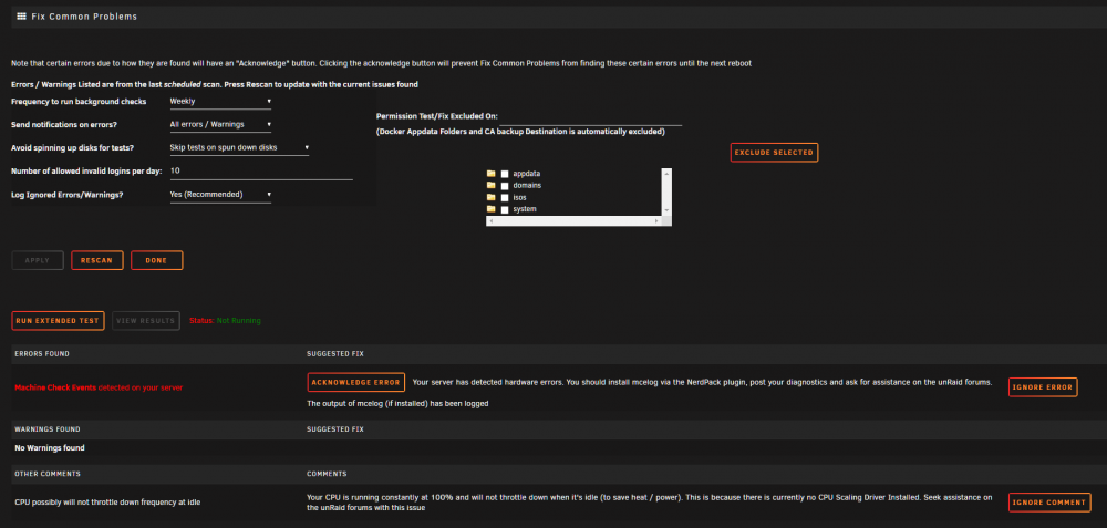

Fix Common Problems is reporting 2 issues
Fix Common Problems is reporting 2 issues - diagnostics are attached.
  • Machine Check Events error, I'm not sure where to view the MCELOG, I've checked under var/logs/  and don't see an MCELOG to run tail on.  I've installed nerdpack, and the mce package but it's still saying to install the plugin?
  • CPU not throttling issue... I'm assuming this is a bios setting?

viewing syslog via ssh simply shows the following with no additional context -- Blutower kernel: mce: [Hardware Error]: Machine check events logged
Can anyone help with the machine check error?  I can figure out the proc issue myself.
Until the mce happens again with mcelog installed, there's going to be no further details listed.  Your BIOS' system event log may have more info
Thanks for the response.  I checked var/log/messages and found nothing useful.  Is there somewhere else I should be checking for the bios event log?
Otherwise it sounds like the next steps are to 'acknowledge' the error in fix common problems and continue about my business until it happens again?
