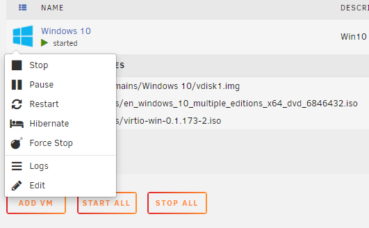

Hi does anyone know how i can get the VNC back in order to connect to the vm ? I started the vm and the option for vnc is gone ? I tried to use realvnc but unable to connect.
i think it has to do with the passthrough of the gpu and audio.. i deleted vm and i was able to get vnc back with the default config.  i have a questions I have 2 VMs build exactly the same and 1 i can rdp into the other i can't. i am able to ping it from network just nor rdp. i have enabled rdp from the vm.
