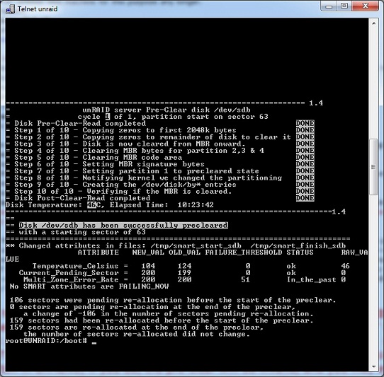

I ran easy recovery professional to test the hard drive.
I ran pre_clear, and everything came back ok.
thanks for the help.  The drive is back alive again and kicking....
It may be back alive, but with 159 re-allocated sectors and an attribute that has apparently failed in the past I'd strongly recommend replacement.
I would not want that disk in my array.  Too risky.
One more thing.. your disk shows a temperature of 46C. (114.8F)
Temperatures above 40C are not recommended... Get more cooling.  It might be a contributing factor.
Joe L.
yeah, I kind of punted on that drive.  It was that hot because I had it sitting on the table with no fan on it.  My mistake......I just ordered two WD20EARS.
thanks for the help.....
