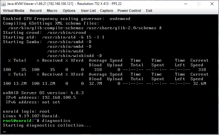

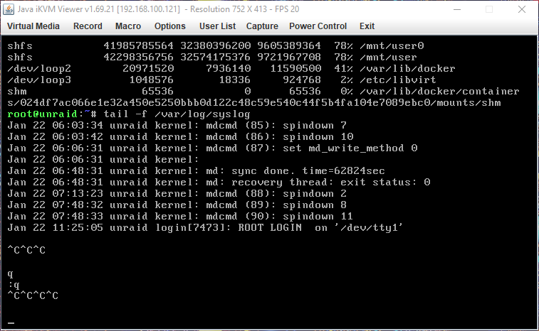

Edit: Since I wrote the above, the server has crashed again in less than 24 hours this time even with minimal workload apart from the parity check, in this case the crash happened shortly after the parity check finished (17 hours). It's currently still in the crashed state but when trying to retrieve the diagnostics via the console the diagnostics process errored and quit (I didn't note the error at the time), since then I tried to view the syslog manually with tail and it froze up and won't let me exit that or even login to another terminal, just sits with a blinking cursor. After checking the USB, the diagnostics file did not complete so safe to assume we've lost this syslog.
