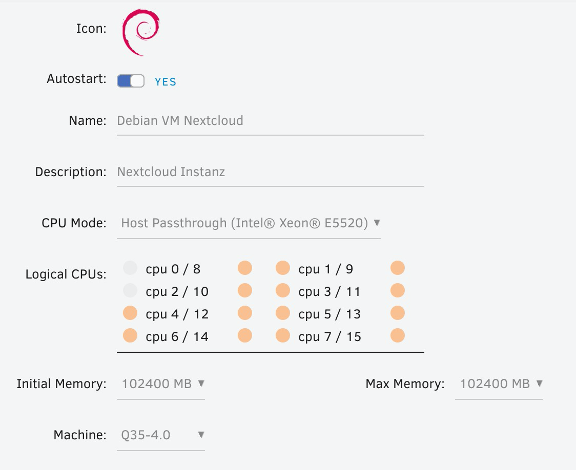

Hi there
I realised that if I change in the VM configuration the machine from Q35-5.1 to Q35-4.0 the VM starts normal. But why did it work before? I did nothing change at all.
And what is the difference between the two machines?
Would be nice if someone give me advice to that.
